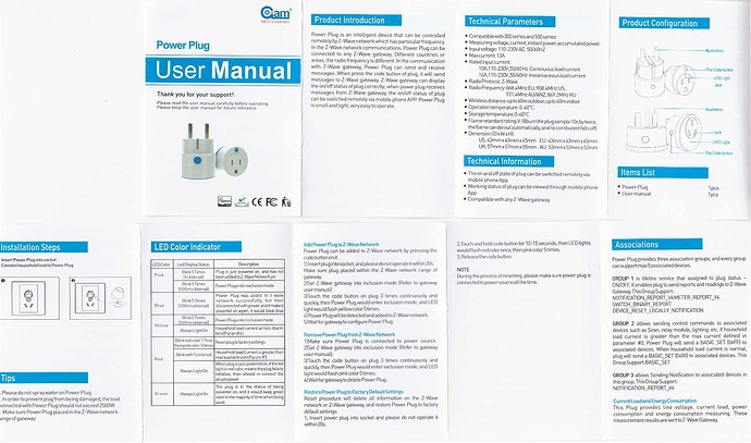

I do not know if it helps, but I ordered the following device from amazon a few days ago and also received it directly from china (NAS-WR01ZE).
Habmin says:
01
And here the manual:
currently I feel overwhelmed to edit the zwave database directly, sorry …
and here is a xml file:
network_ee7b3ad4__node_7.xml (10.9 KB)

This looks indeed like an updated manual! To be honest I also don’t feel confident to edit the XML.
I will try to find time for it tomorrow.
Thank you. I have seen, the scan is not the best, if you need a better I can scan the manual even better …
Fully agree! In fact, I have contacted both the vendor (szneo.com) and the seller from whom I have bought my devices - to get an updated manual. The seller just replied moments ago, providing me with a PDF manual which seems to match-exactly what @miwok has already posted here (which is newer to what I had in the box w/ the device BTW).
Thing is… this new manual is still not a match to the devices I have wrt. their config pameters. And I am not ruling out anything, incl. having buggy FW on those devs, hence my previous Q - if anyone else is observing this exact weird behavior.

I have updated the device with the provided manual and edited the database accordingly.
As I don’t have this device I am not able to change parameters outside the scope of the manual, sorry.
According to the manual this parameter cannot be stored on the device, it is executed via factory reset.
I’ve added the meter_reset channel which can be linked to a Switch itemtype to reset the values.
