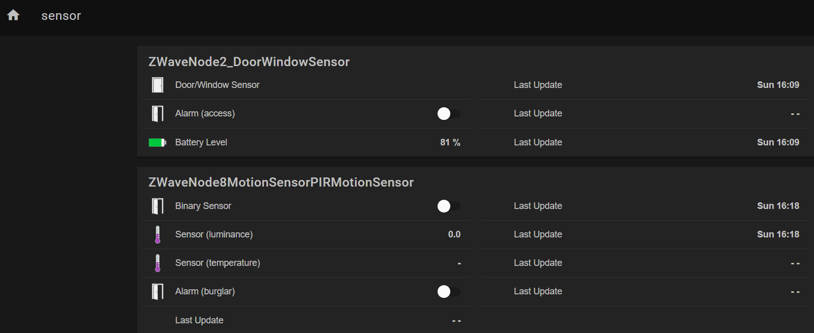

Hi
i have bought those two items
NEO-Coolcam-NAS-DS01Z-Smart-Home-Z-Wave-Plus-Door-Window-Sensor-Compatible-with-Z-wave
NEO Coolcam NAS-PD01Z Smart Home Z-Wave Plus PIR Motion Sensor
My things
i have defined my items :
DateTime ZWaveNode2_DoorWindowSensor_LastUpdate "Last Update [%1$ta %1$tR]" <clock>
DateTime ZWaveNode2DoorWindowSensor_AlarmAccess_LastUpdate "Last Update [%1$ta %1$tR]" <clock>
DateTime ZWaveNode2DoorWindowSensor_BatteryLevel_LastUpdate "Last Update [%1$ta %1$tR]" <clock>
DateTime ZWaveNode8MotionSensorPIRMotionSensor_BinarySensor_LastUpdate "Last Update [%1$ta %1$tR]" <clock>
DateTime ZWaveNode8MotionSensorPIRMotionSensor_SensorLuminance_LastUpdate "Last Update [%1$ta %1$tR]" <clock>
DateTime ZWaveNode8MotionSensorPIRMotionSensor_SensorTemperature_LastUpdate "Last Update [%1$ta %1$tR]" <clock>
DateTime ZWaveNode8MotionSensorPIRMotionSensor_AlarmBurglar_LastUpdate "Last Update [%1$ta %1$tR]" <clock>
DateTime ZWaveNode8MotionSensorPIRMotionSensor_BatteryLevel_LastUpdate "Last Update [%1$ta %1$tR]" <clock>
and a rule file
rule "ZWaveNode2_DoorWindowSensor"
Item ZWaveNode2_DoorWindowSensor changed
ZWaveNode2_DoorWindowSensor_LastUpdate.postUpdate(new DateTimeType())
rule "ZWaveNode2DoorWindowSensor_AlarmAccess_LastUpdate"
Item ZWaveNode2DoorWindowSensor_AlarmAccess changed
ZWaveNode2DoorWindowSensor_AlarmAccess_LastUpdate.postUpdate(new DateTimeType())
rule "ZWaveNode2DoorWindowSensor_BatteryLevel_LastUpdate"
Item ZWaveNode2DoorWindowSensor_BatteryLevel changed
ZWaveNode2DoorWindowSensor_BatteryLevel_LastUpdate.postUpdate(new DateTimeType())
rule "ZWaveNode8MotionSensorPIRMotionSensor_BinarySensor_LastUpdate"
Item ZWaveNode8MotionSensorPIRMotionSensor_BinarySensor changed
ZWaveNode8MotionSensorPIRMotionSensor_BinarySensor_LastUpdate.postUpdate(new DateTimeType())
rule "ZWaveNode8MotionSensorPIRMotionSensor_SensorLuminance_LastUpdate"
Item ZWaveNode8MotionSensorPIRMotionSensor_SensorLuminance changed
ZWaveNode8MotionSensorPIRMotionSensor_SensorLuminance_LastUpdate.postUpdate(new DateTimeType())
rule "ZWaveNode8MotionSensorPIRMotionSensor_SensorTemperature_LastUpdate"
Item ZWaveNode8MotionSensorPIRMotionSensor_SensorTemperature changed
ZWaveNode8MotionSensorPIRMotionSensor_SensorTemperature_LastUpdate.postUpdate(new DateTimeType())
rule "ZWaveNode8MotionSensorPIRMotionSensor_AlarmBurglar_LastUpdate"
Item ZWaveNode8MotionSensorPIRMotionSensor_AlarmBurglar changed
ZWaveNode8MotionSensorPIRMotionSensor_AlarmBurglar_LastUpdate.postUpdate(new DateTimeType())
rule "ZWaveNode8MotionSensorPIRMotionSensor_BatteryLevel_LastUpdate"
Item ZWaveNode8MotionSensorPIRMotionSensor_BatteryLevel changed
ZWaveNode8MotionSensorPIRMotionSensor_BatteryLevel_LastUpdate.postUpdate(new DateTimeType())
your code goes here
not all the channels are updated
even when i am pressing once on the physical button on the door and motion sensor, i can see in the log that
2018-04-01 17:02:34.622 [me.event.ThingUpdatedEvent] - Thing 'zwave:device:162723a63f8:node8' has been updated.
2018-04-01 17:02:40.113 [me.event.ThingUpdatedEvent] - Thing 'zwave:device:162723a63f8:node4' has been updated
what am i missing???

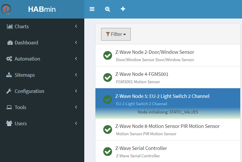

Sorry Newbie here. I just connected a Neo Coolcam Door/window sensor to Openhab 2. Paper UI says its online, but “device no the database” under Configuration/things, and that “device initialisation is not complete”
What do I need to do ?
Check the database if it is in there:
http://www.cd-jackson.com/index.php/zwave/zwave-device-database/zwave-device-list
If not, add it:
http://www.cd-jackson.com/index.php/zwave/zwave-device-database/zwave-device-database-guide
If it is in there update to the latest zwave snapshot binding, because it may not be available in the stable version …
Hi, how did you remove the sensor from the Z-wave network?
is this done with openhab 2.2?
thanks
I see the sensor in the list. How do I export it for incorporation into openhab 2.2 binding that I am on now? is it absolutely necessary to use the latest zwave snapshot binding?
It depends: if the device is an old device it may be in the 2.2 stable. If not, you need to upgrade. But the steps are easy: uninstall the 2.2. binding, download the snapshot, put in in your addons folder, restart openHAB and you should be good to go.
Go to HABmin (or PaperUI), select your controller, go to “Tools”, hit “show advanced settings”, hit “Exclude devices”. Now you have 30 seconds to push the exclude button on your device.
https://docs.openhab.org/addons/bindings/zwave/readme.html#inclusion-and-exclusion
maybe your device is also too far away so the inclusion is not complete. then it could also appear the message “device unknown” or sth. like that.
at least the zwave 2.3 snapshot binding support the sensor, because I’m also running them successfully.
Thanks for confirming the 2.3 snapshot supports this sensor. I think it might be easier just to uninstall 2.2 and install the 2.3 binding.
The Aeotec Z stick was just next to the door/window sensor during inclusion so I dont think it was a distance issue.
I must be doing something wrong. This neo coolcam door/window sensor is still being seen in 2.3 snapshot as not in database, initialisation is not complete.
What am I doing wrong?
Thanks for all your help
hm. I have nearly the same combination like you.
I’m running OH2.2 with 2.3 snapshot binding from beginning of May on Win10 with Aeotec Gen5 Dongle. The only thing what I did was an inclusion with PaperUI instead of the button from the Aeotec Dongle. Placed the sensor nearby the Aeotec Dongle and voila
Maybe I missed it - what what is the device. Exactly what is printed in the UI? Does it show the product IDs? If not, then the initialisation is not complete and until this is done, it won’t be able to reconcile the database. If it’s a battery device, then it’s likely because you didn’t wake the device up.
