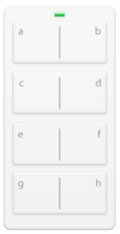

Also, I two Insteon 8 scene mini remote controls. I have no idea how to bring them over into OH2. These are configured in the ISY but do not get imported into OH2. I am reading this thread where it has been done by making entries in a file, but which file?

I have two of Insteon Mini Remote Scene8. These are configured in ISY but are not discovered during the discovery phase. Each of the buttons shows up as Remote-A, Remote-B and so on in ISY. Out of 16 buttons, only one was discovered and that too is showing as Unrecognized Device. Is the hyphen in the device name throwing off the OpenHAB binding discovery process?

So, cross referencing the binding code, Insteon API and my setup, it seems that the mini remote I have (2342-222) has a device category 0x00 and device sub-category 0x1A. The binding’s discovery code does not support this device type.
The binding only supports a handful of devices out of the many listed in the link above. Unless the binding developer fixes it, the device will not be discovered. I see the following error:
No handler found for thing: org.eclipse.smarthome.core.thing.internal.ThingImpl@c0127305
An easy work around is to make a scene using the remote as a controller - you will see the scene changes in OH.
