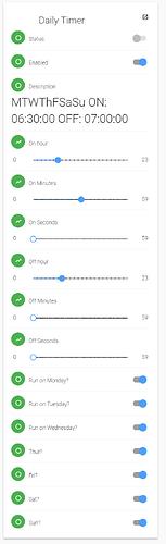

This is what it looks like in the Paper UI:
I envisage in your sitemaps you wouldn’t need all the config details as these shouldn’t change too often.
You can also see the cyptic “Description” any suggestions on a format welcome.

I disagree with that assumption. Many who have been asking for a service like this have been asking BECAUSE they want to be able to change it from the sitemap. Otherwise one could just hard code them as cron triggers to rules. Not sure how that can easily be solved given our current set of default sitemap widgets.

True regarding sitemap - the beauty of this is that you can easily have them in the sitemap if you want to. That being said as they are accessible via the Paper UI it really is up to what works best for your use.

Sorry I think I’ve been a bit loose with my definition here. The timer is a thing - the date time etc is an item (state). See
the screenshot in my second post.
See my screen shot again - I’ve got an hours, minutes and second items that can all be set as numbers using the standard UI. You are right Openhab is missing a date/time picker in the UI for the DateTimeType unfortunately I’m not a web developer so can’t really help here even though it is desperately needed.
