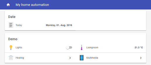

Just to make sure we’re talking about the same thing, this is a sitemap:
Sitemaps were the main control interface in OH2, but have been deprecated in OH3. New users who’ve only seen OH3 often think that pages and sitemaps are the same thing (which is understandable), so I just want to make sure that’s not happening.

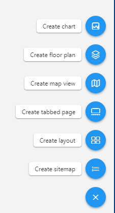

You can create a sitemap in MainUI. Go to “Pages” and press the “+” button at the bottom right corner of the webpage, then select “Create sitemap”.
The reason I mention this is that sitemaps are designed to be VERY simple. If your guests can use smartphones to read QR codes, they can figure out a webpage with 5-6 toggle switches.
