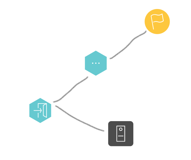

@stevendp Try this (I can’t try as I don’t have a door access system):
The door access action has an option for an attached routine or basic action. Attach a custom routine to it with one virtual output. That routine with the virtual output should become visible in the binding.

I use this also to play a doorbel sound trough my Google Home speakers, works perfectely with the virtual output.

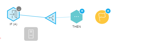

Indeed, I also just found this last night, you can indeed use a conditional action for this, because you can match on incoming call:
I did not find this documented in manual..
Thanks everyone, indeed with a virtual output this works :slight_smile:
