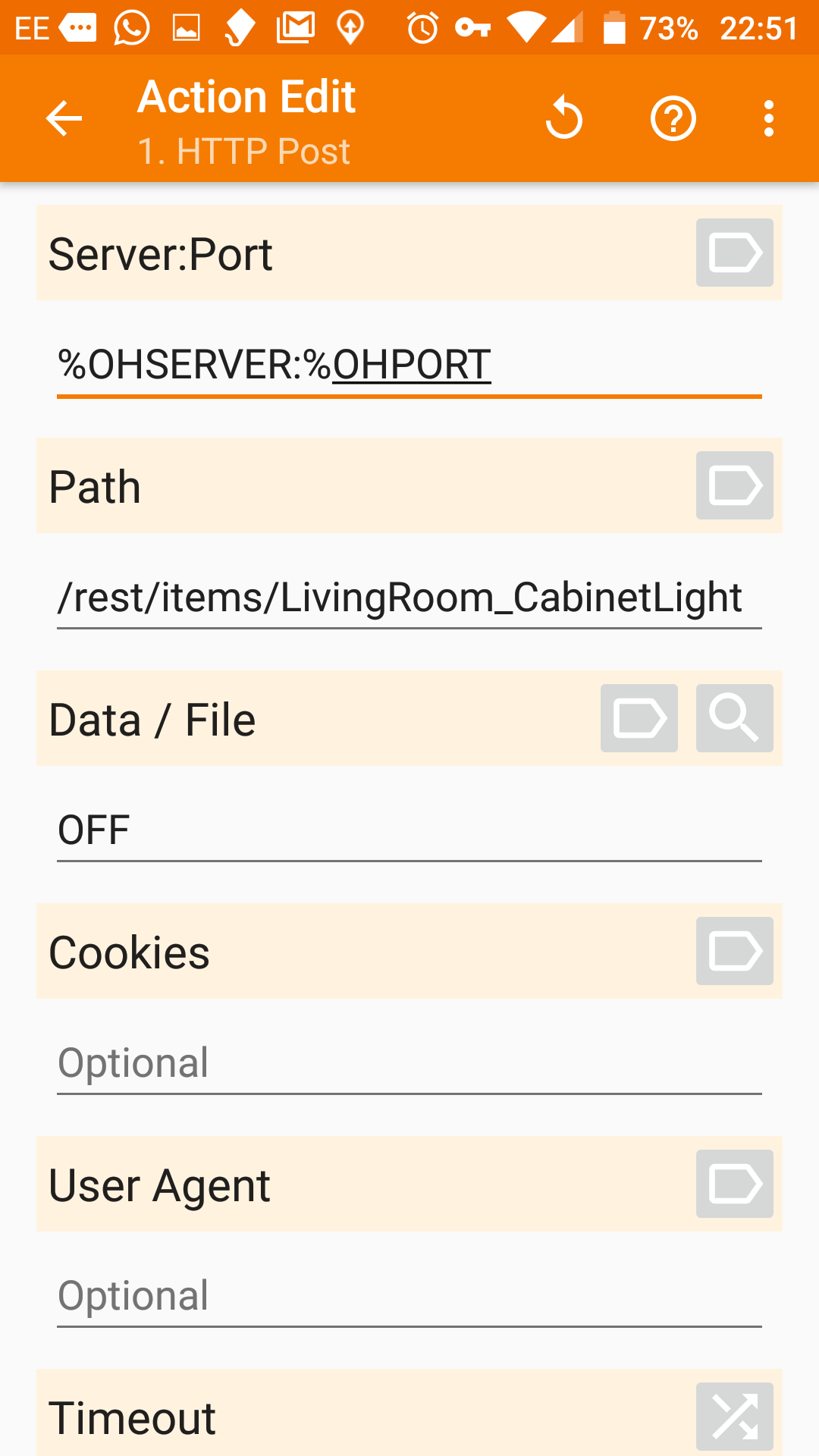

Can someone test out the following shared Task?
In particular, I want to know whether the variables also get exported and whether they retain the values I have them populated with. I couldn’t find the answer in my search through the docs and can’t figure out how to test this myself short of destroying my Tasker setup.
I’ve a couple of Tasks I’d like to share that are relevant to OH but need to make sure I’m not sharing passwords and the like in the process. :wink:
The Task is just a stub for how to send a command to OH. It requires some editing to work:
  • populate OHSERVER ad OHPORT variables
  • modify the http action in the task with the Item name and command to send.
If the variables do get populated in the export I’ll probably default to openhabian and 8080 for them.
Many thanks!
Done
Does not do anything
“Failed to issue command to openHAB:-1”
Right, you need to modify it to make it do something per the description.
Can you check to see if it created the two variables and if so what is in them? If the server has argus.koshak.net then it is copying my full variable. If the variable doesn’t exist then you will need to create it.
The task is really just a stub. You will need to edit at a minimum the OHSERVER variable to point to your OH server or user:password@myopenhab.org and edit the task itself with an Item name and command to send.
The failed message is what you get if Tasker cannot connect to OH.
Thanks for checking!
It has the variables created
I have changed them to 192.168.0.12 and 8080 respectively.
I have modified the item to one of my lights and the command to ON
Doesn’t work.
But maybe it’s a network problem not your task
I’ll have to double check later
Thanks! Were the variables populated? That is good to know.
The variables were there but “null”. There was no value. I has to set them.
