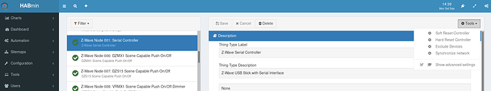

I disagree. In Habmin, you just select the controller> Tools> Show advanced settings> Exclude devices.
Have you tried Habmin, and does it give the sames result?

I’ll give habmin a try for editing, but for exclusion it simply said it could not find the device node 8 when I tried excluding it from there. Maybe because it wasn’t done with the inclusion?
