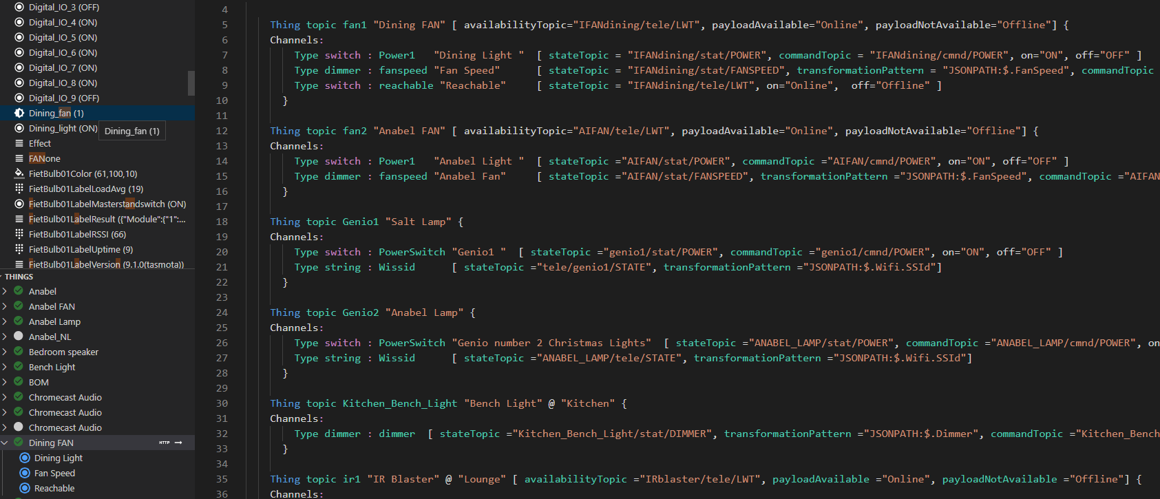

Note that there are two main ways of setting up a broker (Broker Thing) and (device) Things via files:
  1. Your device Things are nested within the Broker Thing. This has a specific syntax.
  2. The Broker Thing is separate (can even be in a separate file), and the device Things reference the Broker Thing. This has a different specific syntax.
Both options have examples in the link above.

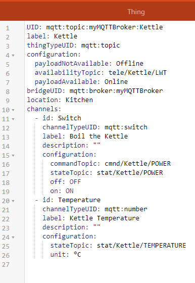

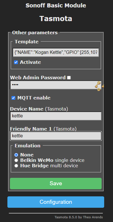

I made a generic-ish MQTT tutorial based on a Tasmota flashed Sonoff Basic - see if anything from there would fit for examples in your post.
openHAB 3
openHAB 2
