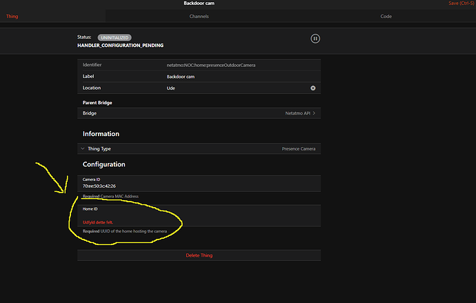

I have same issue, what is the UUID missing marked with yellow in my picture.

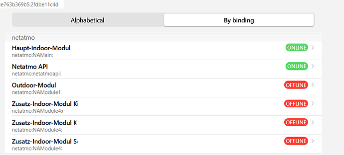

I have a similar problem with a newly installed OH3.
API and indoor-module are online. Outdoor-module and all additional Indoor modules are offline.
The log says
Thing ‘netatmo:NAModule4:*******:********’ changed from OFFLINE: Pending parent object initialization to OFFLINE
Everything works on my productive OH2.5.11
