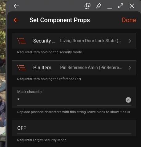

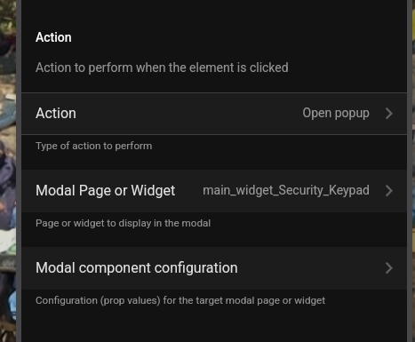

Hi @hmerk , i was playing with this keypad. At the above line there is a check with reference pin. If the pin is incorrect it still calls the action command. And if the value is empty it gives error as communication error.
Is there is way to not call the action command if pin validation fails?
I tried different things but nothing worked.
Amin

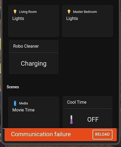

Thank for the quick reply.
here is the error I see if I enter incorrect pin. In App

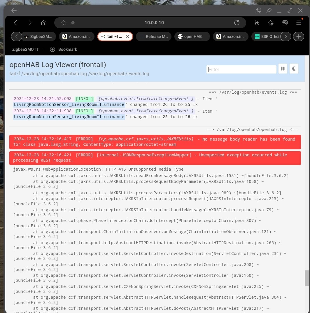

In Logs
2024-12-28 14:22:16.421 [ERROR] [internal.JSONResponseExceptionMapper] - Unexpected exception occurred while processing REST request.

I m using a switch item for control here. What I m understanding is if the pin is incorrect, it tries to assign empty state to switch item which gives above error. When I assign it proper ON or OFF state then no error is thrown.
But ideally, there should be no update to item if pin validation fails. Hope this clarifies the issue.

Now used the above code as is no change. but getting same error.
Settings details.
widget config
Ok, you are trying to control a Switch Item with the keypad. This is not what it is designed for. We are sending a predefined string to a String (mode) item.
Ok, got it. Thanks!
