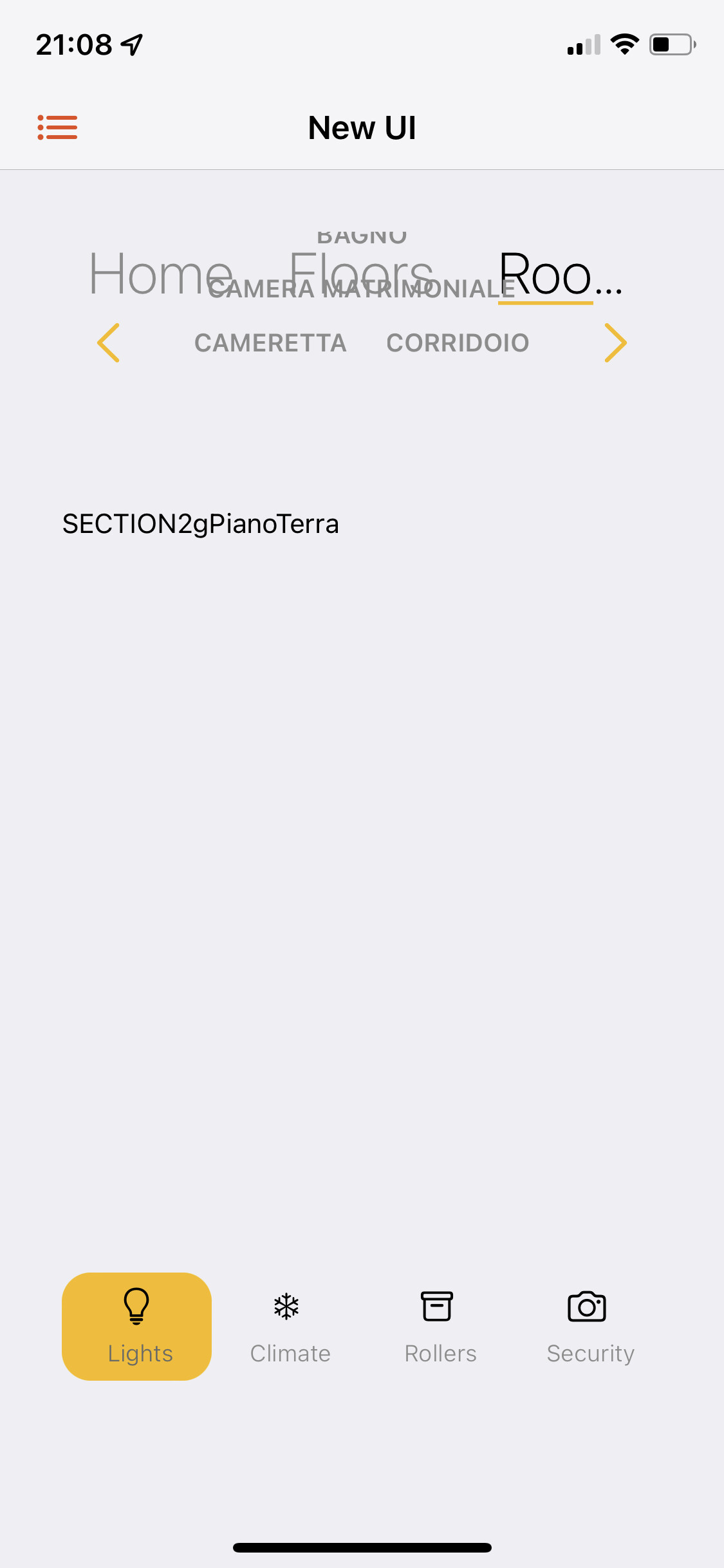

Ok guys, this version should work now (@Nic0205, not much thad I had to fix)

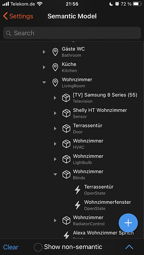

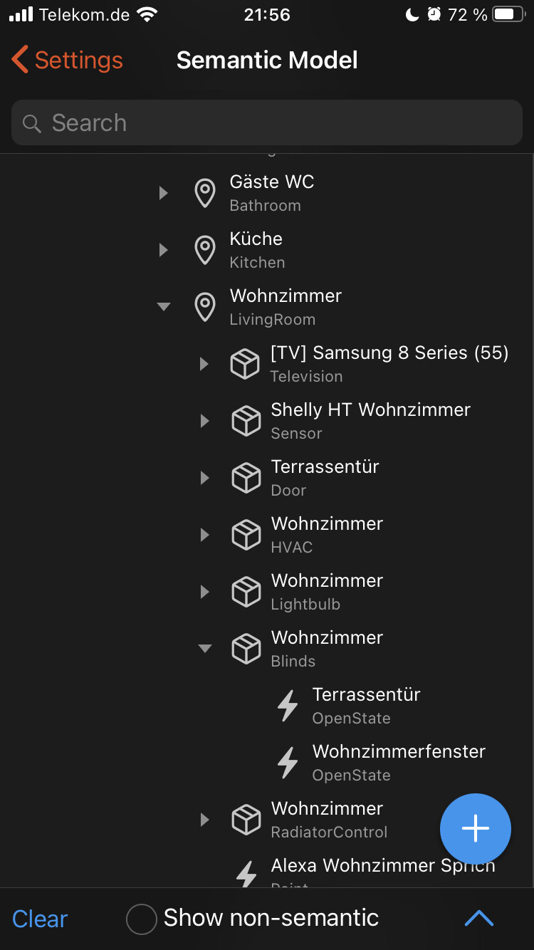

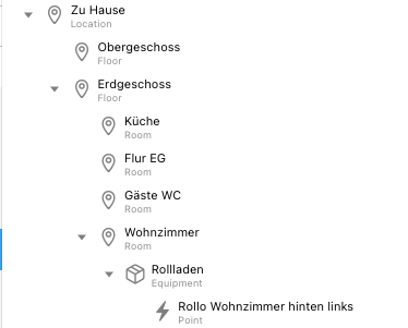

My model looks like:

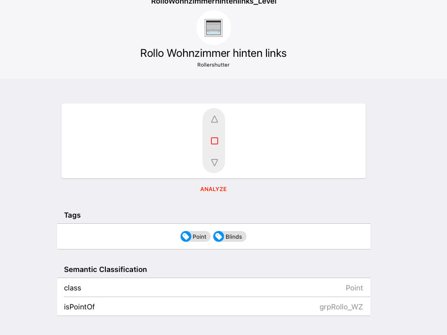

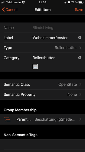

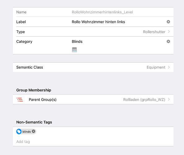

And Rollo Wohnzimmer hinten links has the following definition:
For sure I missed something - but what?
You missed this
And some posts before.
You need to set the tags like shown, as not everybody tags the rooms just ad „Room“. There are different room types in the semantics…
And that‘s why my change in the repeater was needed.
For rhe blinds, don‘t tag it just as equipment, but tag it as equipment->blinds

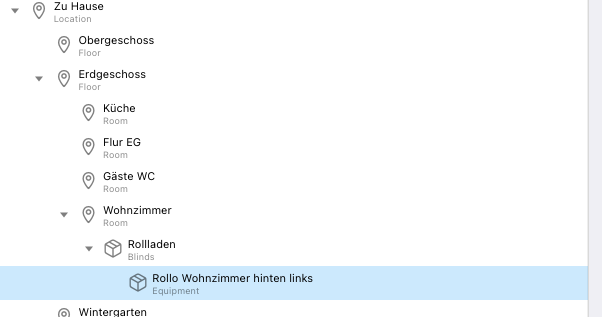

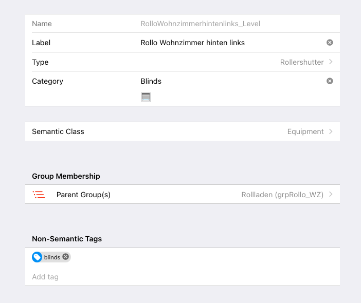

This is how I tagged it:
And this is my model now:
Could you please post a screenshot of your blinds?
From mobile with this version is really hard to select the right room…
Don’t need to post a screenshot. This is quite simple to explain.
You have nested equipments in the livingroom, that‘s not supported. Next issue is that your blinds group is tagged as equipment blinds, but your blinds are tagged only as equipment.
The group should not be tagged as equipment, but just as a group. But this will not solve the issue. You need to properly tag the blinds and move them one level up in the model.
If you really need a blinds group, create a non semantic group for them.
i don’t get it. For sure it’s my own inexperience but I have not understand it.
I have a floor “Erdgeschoss” in this floor there is a room “livingroom”. In this room there is a blinds equipment and in there my blind is assigned. The blind is tagged as “Blinds”.
As a test I just assigned the blind to livingroom without an equipment - but does also not work…

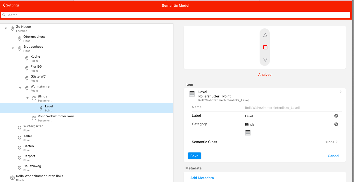

Ok, perhaps a screenshot does explain better
Thank you!
Now I got it! :partying_face:

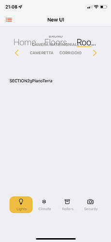

@JustinG
Hey Justin,
I tried to look what’s going on here. On Desktop Browser all is fine, but on mobile the wrapping does not work. I tried it with Chrome on Android and with Safari on iOS but it’s all the same.
This behavior could be reproduced with your original-code too - Do you have an idea what to do?
I will try with try and error also :wink:
