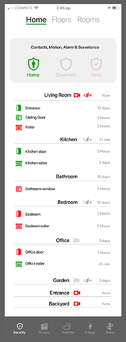

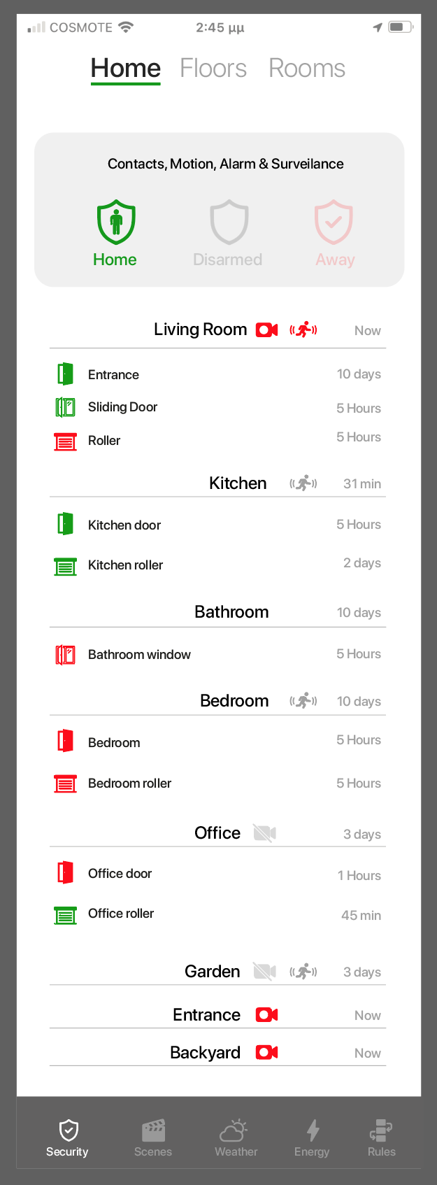

@hmerk Regarding the security widget: I’m struggling a lot to put all valuable info you gave us in a widget..
In my view, proceed with your way. It’s minimal and to the point. I’m just sharing my draft. It would be nice if you spend some time to review:
0_Security.pdf (53.9 KB)
I will check later today, already have some improvements in mind. I will try to combine both (your draft and my ideas)
Some early comments.
In general, information on cameras and motion sensors in such a list should be possible. What seems to be impossible is the time information for delta since last change. I have to think if there is a possibility to access pesistence data in expressions. Right now, I have no clue.
Only guess would be to work with calculated proxy items, but this would mean a lot of effort (additional items and rules for each camera and motion sensor)
If you want door and window states as well, effort is raising again.

@Dimitris What’s your opinion on this ? Checking your screenshot, it qould be at least 17 additional items to be created.
Exactly, just a second link to the relevant channel by using the timestamp profile :+1:
@hmerk If we talking for the security widget then go for the simplest and easiest solution. What you have done with security widget in more than enough! The draft I’ve sent is some “not finished - not enough studied” idea!
Tommorow I will search further to enhance your widget. You know, to do some fancy stuff on it!!
So right. Can you help me design another type of widget for that equipment? Just give me an example.

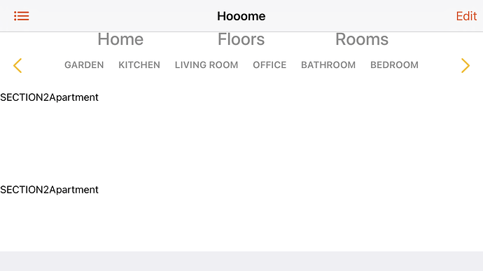

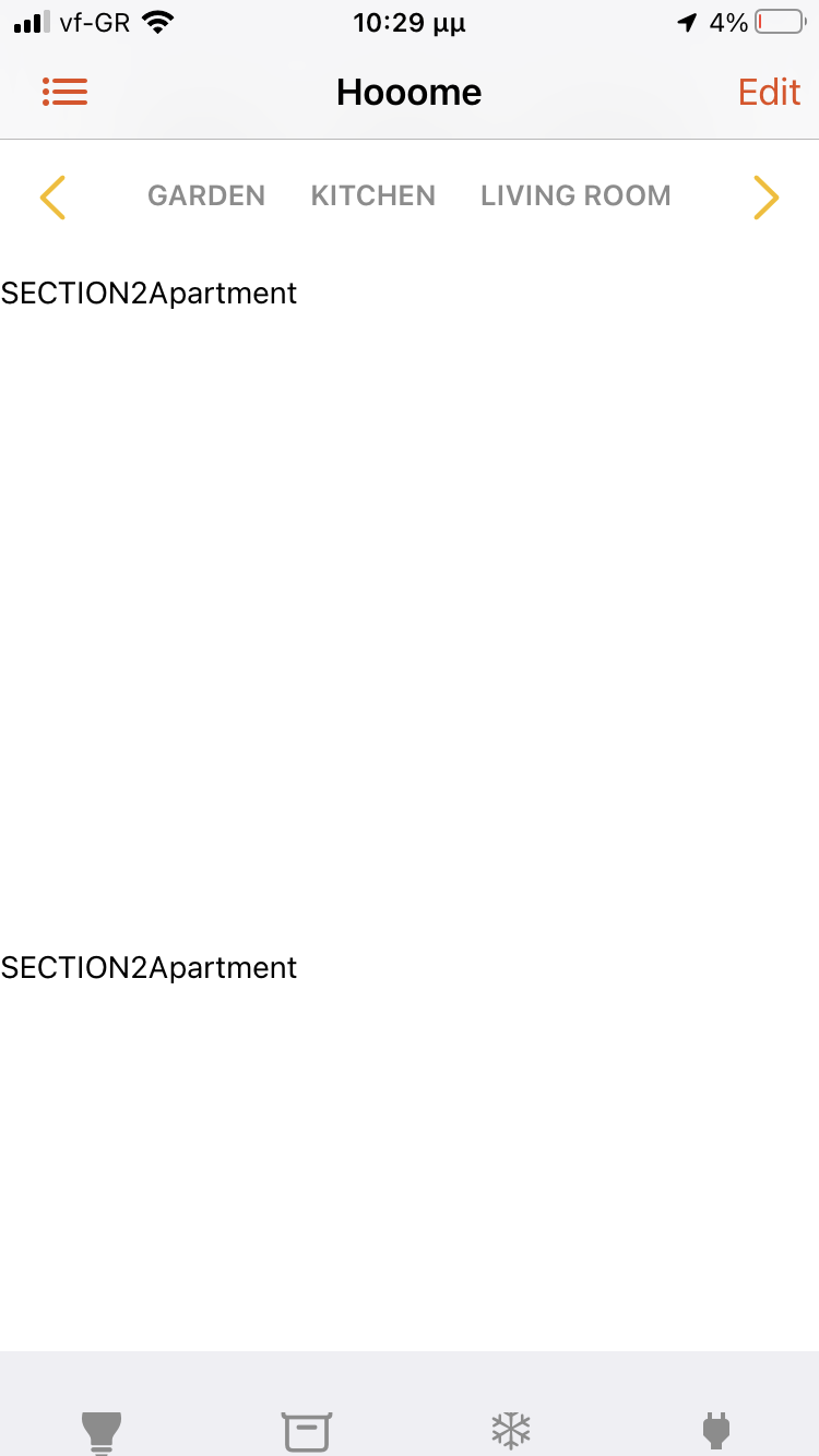

here the code for the stylesheet styled bottom navbar. Reduces code :wink:
uid: main_widget_poc
tags: []
props:
  parameters:
    - description: Set default color for Text
      label: Text color
      required: false
      type: TEXT
    - default: RGB(96, 96, 96)
      label: Bottom-Navbar-Color
      required: false
      type: TEXT
    - default: Somewhere
      description: Name for your weather location
      label: Weather Location
      required: false
      type: TEXT
    - context: item
      description: Name of scenes group item
      label: Scenes Group
      required: false
      type: TEXT
    - context: item
      description: Name of security group item
      label: Security Group
      required: false
      type: TEXT
    - context: item
      description: Security Mode Item
      label: Security Mode
      required: false
      type: TEXT
    - context: item
      description: Security PIN Item
      label: Security PIN
      required: false
      type: TEXT
  parameterGroups: []
timestamp: Sep 25, 2022, 4:06:06 PM

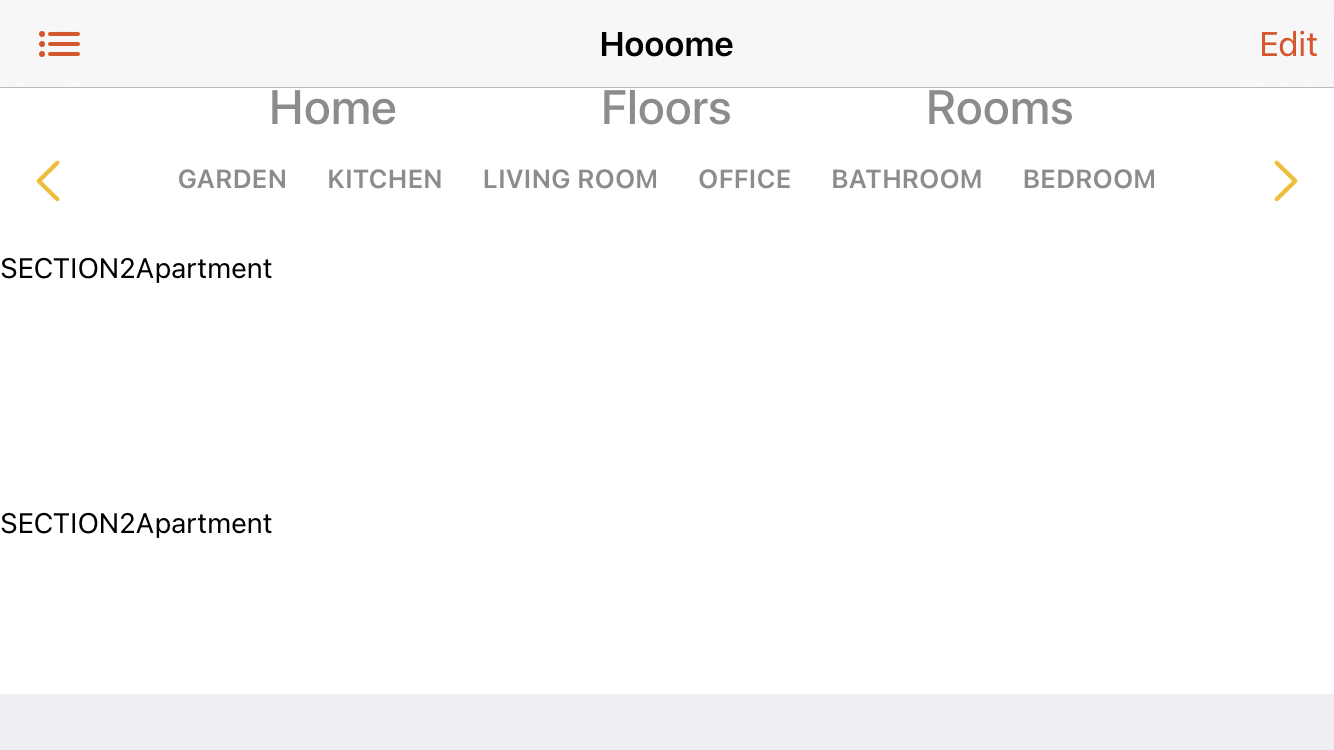

Here is the code for the page
  label: openPage
  sidebar: true
  hideNavbar: true
  showFullscreenIcon: false
  hideSidebarIcon: true
  style:
    --f7-block-padding-horizontal: 0px
    --f7-navbar-height: 0
blocks:
  - component: oh-block
      stylesheet: |
        .block:first-child{
          margin-top: 15px;
      default:
        - component: oh-grid-row
          config: {}
            default:
              - component: oh-grid-col
                config: {}
                  default:
                    - component: widget:main_widget
                        locationTitle:
                        scenesGroup:
                        securityGroup:
                        securityMode:
                        referencePIN:
masonry: null
grid: []
@Team, following this discussion
we should overthink the scenes card and make it stateless….
@Dimitris Here is a little spoiler of what I am just working on :wink:
… I forgot to implement the stylesheet for the navbar for the home menu.
Please see updated code:
uid: main_widget
tags: []
props:
  parameters:
      label: Text color
      required: false
      type: TEXT
      required: false
      type: TEXT
      required: false
      type: TEXT
    - context: item
      label: Scenes Group
      required: false
      type: TEXT
    - context: item
      required: false
      type: TEXT
    - context: item
      required: false
      type: TEXT
    - context: item
      label: Security PIN
      required: false
      type: TEXT
  parameterGroups: []
component: f7-block
  style:
    display: flex
    flex-direction: column
    height: calc(100vh - var(--f7-toolbar-height) - var(--f7-safe-area-bottom) - var(--f7-safe-area-top))
    justify-content: space-between
    margin: 0
    padding: 0
    width: 100%
    background: =(themeOptions.dark=="light") ? ("white"):("black")
    --menu-text-color: '= (!props.textColor) ? (themeOptions.dark=="light")? black : white : props.textColor'
    --f7-button-text-color: "#8c8c8c"
    --opmw-menu-text-color: =(themeOptions.dark=="light")?("#8C8C8C"):("#848484")
  stylesheet: >
    .selected_menu_item {
      color: var(--menu-text-color);
      text-decoration-color: #F8BB00 !important;
      text-decoration: underline;
      text-underline-offset: 2.px;
      font-weight: bold;
    .unselected_menu_item {
      color: #8C8C8C;
      font-weight: 300;
    .selected_bottom_navbar_item {
     color: white;
     font-size: 12px;
     height: auto;
     --f7-button-bg-color: transparent;
    .unselected_bottom_navbar_item {
     color: "#8c8c8c";
     font-size: 12px;
     height: auto;
  default:
    - component: f7-block
        style:
          flex: 0 0 auto
          overflow: scroll
        default:
          - component: f7-segmented
              style:
                flex: 1 1 auto
                justify-content: center
                margin-left: 2%
                margin-right: 2%
                gap: 10px
              default:
                - component: oh-repeater
                    for: baseMenu
                    fragment: true
                    in:
                      - name: Home
                      - name: Floors
                      - name: Rooms
                    map: loop.baseMenu.name
                    sourceType: array
                    default:
                      - component: oh-button
                          action: variable
                          actionVariable: objVar
                          actionVariableValue:
                            selectSection: ="SECTION" + loop.baseMenu_idx
                          large: true
                          class: '=vars.objVar.selectSection=="SECTION" + loop.baseMenu_idx ? "selected_menu_item" : "unselected_menu_item"'
                          style:
                            font-size: 24px
                            font-weight: 200
                            flex: 0 1 auto
                            width: auto
                          text: =loop.baseMenu
          - component: f7-row
              style:
                align-items: center
                display: flex
                flex-direction: row
                flex-wrap: nowrap
                height: 2em
                width: 100%
              visible: false
              default:
                    action: variable
                    actionVariable: buttonIndexHome
                    actionVariableValue: =(vars.buttonIndexHome || 0) - 1
                    iconF7: chevron_left
                    style:
                      color: "#F8BB00"
                      flex: 0 0 auto
                      height: 2em
                    for: menuArray
                    fragment: true
                    sourceType: itemsWithTags
                    itemTags: Floor
                    fetchMetadata: widgetOrder
                    map: loop.menuArray_source
                    default:
                      - component: f7-row
                          style:
                            display: flex
                            height: 2em
                            overflow: hidden
                          default:
                                for: menuButtonHome
                                fragment: true
                                in: =loop.menuArray
                                filter: loop.menuArray_idx == 0
                                map: ((loop.menuButtonHome.metadata && loop.menuButtonHome.metadata.widgetOrder && loop.menuButtonHome.metadata.widgetOrder.value) || 0).toString().padStart(3,'0') + '&' + loop.menuButtonHome_idx
                                default:
                                      action: variable
                                      actionVariable: floor
                                      actionVariableValue: =loop.menuArray[loop.menuButtonHome_source.sort()[loop.menuButtonHome_idx].split('&')[1]].name
                                      style:
                                        flex: 0 0 auto
                                        height: 2em
                                        order: =(((vars.buttonIndexHome || 0) % loop.menuButtonHome_source.length) + loop.menuButtonHome_source.length + loop.menuButtonHome_idx) % loop.menuButtonHome_source.length
                                      text: =loop.menuArray[loop.menuButtonHome_source.sort()[loop.menuButtonHome_idx].split('&')[1]].label
                    action: variable
                    actionVariableValue: =(vars.buttonIndexHome || 0) + 1
                    iconF7: chevron_right
                    style:
                      color: "#F8BB00"
                      flex: 0 0 auto
                      height: 2em
          - component: f7-row
              style:
                align-items: center
                display: flex
                flex-direction: row
                flex-wrap: nowrap
                height: 2em
                width: 100%
              visible: '=vars.objVar ? (vars.objVar.selectSection=="SECTION1") ? true : false : false'
              default:
                    action: variable
                    actionVariable: buttonIndexFloor
                    actionVariableValue: =(vars.buttonIndexFloor || 0) - 1
                    style:
                      color: "#F8BB00"
                      flex: 0 0 auto
                      height: 2em
                    for: menuArray
                    fragment: true
                    itemTags: Floor
                    default:
                      - component: f7-row
                          style:
                            display: flex
                            height: 2em
                            overflow: hidden
                          default:
                                for: menuButtonFloor
                                fragment: true
                                in: =loop.menuArray
                                map: ((loop.menuButtonFloor.metadata && loop.menuButtonFloor.metadata.widgetOrder && loop.menuButtonFloor.metadata.widgetOrder.value) || 0).toString().padStart(3,'0') + '&' + loop.menuButtonFloor_idx
                                default:
                                      action: variable
                                      actionVariableValue: =loop.menuArray[loop.menuButtonFloor_source.sort()[loop.menuButtonFloor_idx].split('&')[1]].name
                                      class: '=(vars.floor ==(loop.menuArray[loop.menuButtonFloor_source.sort()[loop.menuButtonFloor_idx].split("&")[1]].name)) ? "selected_menu_item" : "unselected_menu_item"'
                                      style:
                                        flex: 0 0 auto
                                        height: 2em
                                        order: =(((vars.buttonIndexFloor || 0) % loop.menuButtonFloor_source.length) + loop.menuButtonFloor_source.length + loop.menuButtonFloor_idx) % loop.menuButtonFloor_source.length
                                        text-underline-offset: 4px
                                      text: =loop.menuArray[loop.menuButtonFloor_source.sort()[loop.menuButtonFloor_idx].split('&')[1]].label
                    action: variable
                    actionVariableValue: =(vars.buttonIndexFloor || 0) + 1
                    style:
                      color: "#F8BB00"
                      flex: 0 0 auto
                      height: 2em
          - component: f7-row
              style:
                align-items: center
                display: flex
                flex-direction: row
                flex-wrap: nowrap
                height: 2em
                width: 100%
              visible: '=vars.objVar ? (vars.objVar.selectSection=="SECTION2") ? true : false : false'
              default:
                    action: variable
                    actionVariable: buttonIndexRoom
                    actionVariableValue: =(vars.buttonIndexRoom || 0) - 1
                    style:
                      color: "#F8BB00"
                      flex: 0 0 auto
                      height: 2em
                    for: menuArrayRoom
                    fragment: true
                    itemTags: =vars.floor
                    map: loop.menuArrayRoom_source
                    default:
                      - component: f7-row
                          style:
                            display: flex
                            height: 2em
                            overflow: hidden
                          default:
                                for: menuButtonRoom
                                fragment: true
                                in: =loop.menuArrayRoom
                                filter: loop.menuArrayRoom_idx == 0
                                map: ((loop.menuButtonRoom.metadata && loop.menuButtonRoom.metadata.widgetOrder && loop.menuButtonRoom.metadata.widgetOrder.value) || 0).toString().padStart(3,'0') + '&' + loop.menuButtonRoom_idx
                                default:
                                      action: variable
                                      actionVariable: room
                                      actionVariableValue: =loop.menuArrayRoom[loop.menuButtonRoom_source.sort()[loop.menuButtonRoom_idx].split('&')[1]].name
                                      class: '=(vars.room ==(loop.menuArrayRoom[loop.menuButtonRoom_source.sort()[loop.menuButtonRoom_idx].split("&")[1]].name)) ? "selected_menu_item" : "unselected_menu_item"'
                                      style:
                                        flex: 0 0 auto
                                        height: 2em
                                        order: =(((vars.buttonIndexRoom || 0) % loop.menuButtonRoom_source.length) + loop.menuButtonRoom_source.length + loop.menuButtonRoom_idx) % loop.menuButtonRoom_source.length
                                      text: =loop.menuArrayRoom[loop.menuButtonRoom_source.sort()[loop.menuButtonRoom_idx].split('&')[1]].label
                    action: variable
                    actionVariableValue: =(vars.buttonIndexRoom || 0) + 1
                    style:
                      color: "#F8BB00"
                      flex: 0 0 auto
                      height: 2em
    - component: widget:main_widget_Home_Card
        locationTitle: =props.locationTitle
        scenesGroup: =props.scenesGroup
        securityGroup: =props.securityGroup
        securityMode: =props.securityMode
        referencePIN: =props.referencePIN
    - component: widget:main_widget_Floor_Card
    - component: widget:main_widget_Room_Card
        style:
          flex: 0 0 auto
          overflow: scroll
          margin-bottom: -4em
          background: =props.bnavColor
          border-radius: 0px 0px 10px 10px
        visible: '=vars.objVar ? (vars.objVar.selectSection=="SECTION0") ? true : false : false'
        default:
              default:
                    action: variable
                      selectSection: =vars.objVar.selectSection
                      selectThing: Security
                    class: '=(vars.objVar && (vars.objVar.selectThing=="Security")) ? "selected_bottom_navbar_item display-flex flex-direction-column padding-top half" : "unselected_bottom_navbar_item display-flex flex-direction-column padding-top half"'
                    icon-f7: shield_fill
                    iconColor: '=items[props.securityMode].state != "disarmed"  ? "red" : "gray"'
                    text: Security
                    action: variable
                      selectThing: Scenes
                    class: '=(vars.objVar && (vars.objVar.selectThing=="Scenes")) ? "selected_bottom_navbar_item display-flex flex-direction-column padding-top half" : "unselected_bottom_navbar_item display-flex flex-direction-column padding-top half"'
                    icon-f7: rectangle_on_rectangle_angled
                    text: Scenes
                    action: variable
                      selectThing: Weather
                    class: '=(vars.objVar && (vars.objVar.selectThing=="Weather")) ? "selected_bottom_navbar_item display-flex flex-direction-column padding-top half" : "unselected_bottom_navbar_item display-flex flex-direction-column padding-top half"'
                    icon-f7: cloud
                    text: Weather
                    action: variable
                      selectThing: Energy
                    class: '=(vars.objVar && (vars.objVar.selectThing=="Energy")) ? "selected_bottom_navbar_item display-flex flex-direction-column padding-top half" : "unselected_bottom_navbar_item display-flex flex-direction-column padding-top half"'
                    icon-f7: bolt_fill
                    text: Energy
        style:
          flex: 0 0 auto
          overflow: scroll
          margin-bottom: -4em
        visible: '=vars.objVar ? (vars.objVar.selectSection=="SECTION0") ? false : true : false'
        default:
              default:
                    action: variable
                      selectThing: Lights
                    class: '=(vars.objVar && (vars.objVar.selectThing=="Lights")) ? "selected_bottom_navbar_item display-flex flex-direction-column padding-top half" : "unselected_bottom_navbar_item display-flex flex-direction-column padding-top half"'
                    icon-f7: lightbulb_fill
                    text: Lights
                    action: variable
                      selectThing: Rollers
                    class: '=(vars.objVar && (vars.objVar.selectThing=="Rollers")) ? "selected_bottom_navbar_item display-flex flex-direction-column padding-top half" : "unselected_bottom_navbar_item display-flex flex-direction-column padding-top half"'
                    icon-f7: archivebox
                    text: Shades
                    action: variable
                      selectThing: Climate
                    class: '=(vars.objVar && (vars.objVar.selectThing=="Climate")) ? "selected_bottom_navbar_item display-flex flex-direction-column padding-top half" : "unselected_bottom_navbar_item display-flex flex-direction-column padding-top half"'
                    icon-f7: snow
                    text: Climate
                    action: variable
                      selectThing: Appliances
                    iconMaterial: power
                    class: '=(vars.objVar && (vars.objVar.selectThing=="Appliances")) ? "selected_bottom_navbar_item display-flex flex-direction-column padding-top half" : "unselected_bottom_navbar_item display-flex flex-direction-column padding-top half"'
                    text: Appliances
