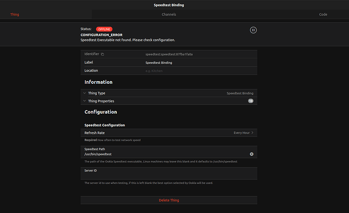

Inspired by the new Speedtest binding from @bhomeyer, I tried to perform an installation on my Synology NAS that is similar to that of the user @muelli1967. My requirements are openhab 3.1 in Docker. I have stored the file org.openhab.binding.speedtest-3.1.0-SNAPSHOT.jar (v 0.5) under addons and installed it under usr/ bin/ Ookla-Speedtest. I also accepted the license and the exec binding is also installed. The test goes well and the result looks exactly like @ muelli1967.
However, if I then install the Speedtest Thing, the error message “CONFIGURATION_ERROR Speedtest Executable not found. Please check configuration. "
I tried it with user 9001 (suggested when creating the openhab container) and user 1000. The same error message over and over again.
What did I forget or what am I doing wrong? Who can help me here?

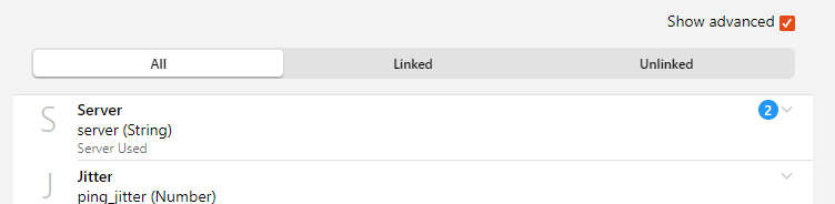

I’m not sure what you mean by this, as there is a channel for manually triggering a speedtest.
You have to click “Show Advanced” to see it.
If you don’t have it, make sure you have the latest version of the binding, as mentioned earlier in the thread.

Your installation path is different from your config. Both paths need to be the same.

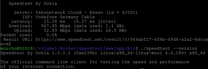

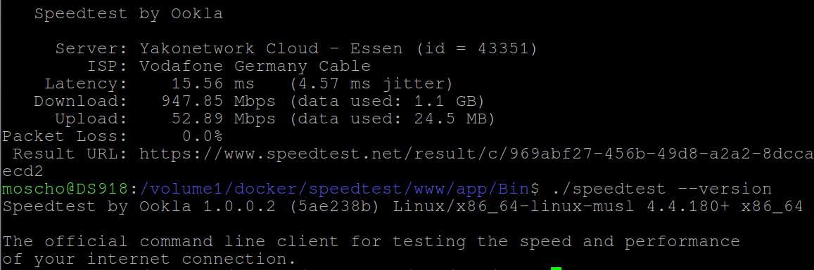

OK, try again. I have now set up a Docker container for Ookla Speedtest. The file Speedtest is in the directory “/volume1/docker/speedtest/www/app/Bin. With the call ./speedtest I get the result below in the command line. Via the file” org.openhab.binding.speedtest-3.1.0 -SNAPSHOT.jar “(copied to the /openhab/addons directory) I get the desired speedtest binding. I have adjusted the path to the” Speedtest "file because it is now in the Speedtest container. However, I still get the same error message . Unfortunately I have no more ideas, who can help?
Note: Speedtest-CLI is not for Docker in a NAS, but e.g. B. for Raspberry.
I´m not sure if the cotainers can freely access eachother.
As far as i remember it´s not possible to access the commandline of another docker container.
It´s possible to create a virtual network that both containers can access.
