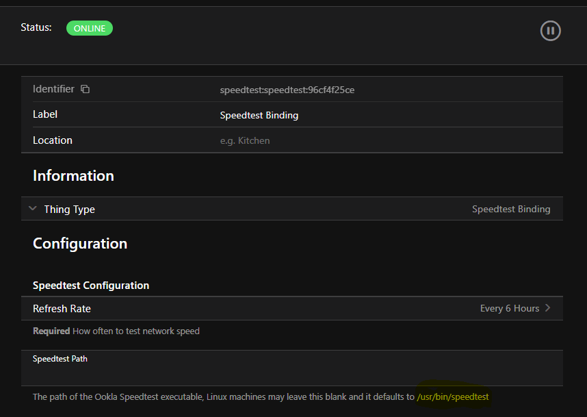

Yes. I’m on 3.2 and speedtest is working fine for me on openhabian system (Raspi4). Here are the steps I have done:
cd /usr/bin
speedtest
  • Create Thing from Speedtest Binding
No extra settings needed → /usr/bin/speedtest is default path with executable

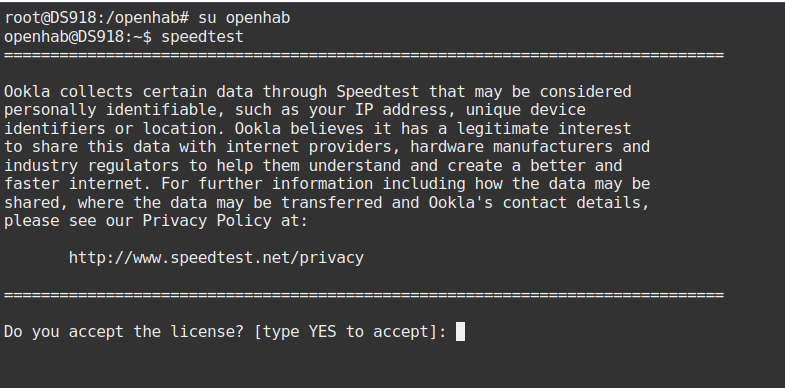

Mine was working fine for ages as well. I’m using X64-based system so @michaeljoos option will not work as this is for ARM. However, after a lot of uninstalling everything and trying again, I was still getting the “Not returning valid results” until I tried @RGroll 's option of running sudo -u openhab /usr/bin/speedtest which asks you to accept the license agreement. Did this, and now it is all working again! If this doesn;t work for you, try removing and re-adding the Ookla repo and speedtest version, then try the above.
Ookla speed test finally works under OH3.2! I run openhab in Docker, so I had to go this way:
1.) Copy “org.openhab.binding.speedtest-3.1.0-SNAPSHOT.jar” into the add-on folder
2.) Download the file “ookla-speedtest-1.1.1-linux-x86_64.tgz”, extract it and copy “speedtest” to /usr/ bin
3.) Under Docker → Container → Openhab3 → Terminal start Speedtest once in the command line to accept the license (see screenshot)
Thank you. This solution worked for me too.

My Speedtest now runs under Openhab 3.3 in Docker.
I need to start ./speedtest manually from time to time in order to accept the license terms:
Do you accept the license? [type YES to accept]: YES
License acceptance recorded. Continuing.
Be aware, that you need to use the right user, e.g. openhab and not your default user.
I compiled a new version of the binding which is now automatically accepting also GDBR in addition to the license terms only.
old:
/openhab/conf/scripts/speedtest/speedtest -f json --accept-license
new:
/openhab/conf/scripts/speedtest/speedtest -f json --accept-license --accept-gdpr
I hope that solves the repeatedly raised issues arround that reported CONFIGURATION_ERROR.
