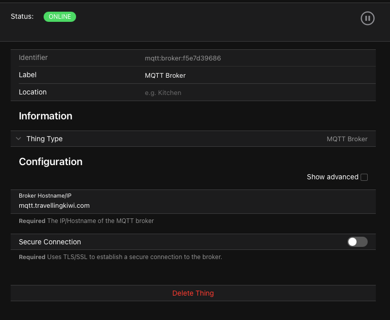

I haven’t yet worked out how to configure OH3 in the same way. But from the GUI I can configure an mqtt ‘thing’ that connects to my mqtt server.
e.g.
And it finds updates… And logs a trigger
events.log:2021-05-04 08:14:14.792 [INFO ] [openhab.event.ChannelTriggeredEvent ] - mqtt:broker:f5e7d39686:mqtt_sensor_temp triggered -1576735667 000336da : humid 57.20 temp 13.50 heat_ind 12.39

You’ve shown the configuration for your Broker Thing. Can you show it for your Generic MQTT Thing?
Sounds like it might be worth going over the basics of Thing - Item interaction. There’s now a Getting Started tutorial which might help.
Otherwise, this tutorial goes through the steps of adding an MQTT relay into openHAB 3 using the UI and processing some data from that relay using a Transformation Service - it may help you. If you’re confident that your Broker Thing is setup correctly you could start from step 4.

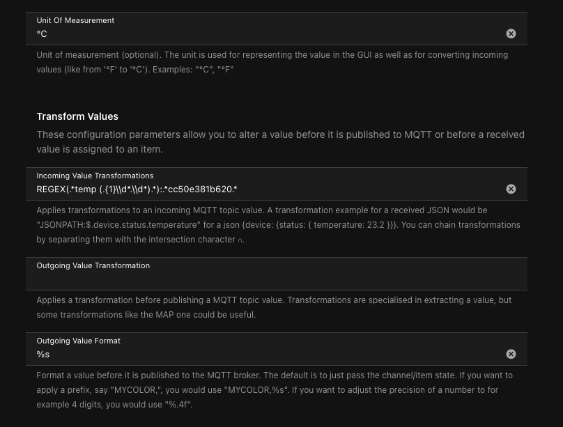

Question. In the transformation for the Generic MQTT thing… Is the REGEX syntax the same as the OH1 REGEX syntax? e.g.
I’m guessing not, because although the mqtt broker logs the inbound message
2021-05-04 11:38:46.491 [INFO ] [openhab.event.ChannelTriggeredEvent ] - mqtt:broker:f5e7d39686:mqtt_sensor_temp triggered 296 cc50e381b620 : humid 50.55 temp 13.89 press 996.24
There is no update to the item connected to the channel

The syntax for transforms in the GUI is not the same as the syntax used in the items files… Sigh…
Whereas the items takes a syntax such as
mosq:sensor/temperature:state:REGEX(.*temp (.{1}\\d*.\\d*).*):.*cc50e381b620.*
To take that regex and place it into the transform in the GUI it becomes
REGEX:.*cc50e381b620 : .*temp (.{1}\d*.\d*).*
I’m not sure whether the GUI has a separate filter… So I moved that into the REGEX itself. But in addition there’s the REGEX() changing to REGEX: and of course the \d no longer needs to be escaped as \d
Annoyingly the regex still has to match the whole string. Something that the docs imply differently. Because the docs specifically mention the ^ anchor, but if the whole string HAS to match then an explicit ^ isn’t required because it’s implied.
Might I mention the profiles as an aside… Having a profile called ‘default’ that isn’t the default would tend to be somewhat obscure too…
It does not. Nothing to do with GUI or REGEX directly, the OH1 binding offered separate parameters for ‘transformation’ and for ‘filtering’. OH2 binding (as carried forward to OH3) only has transformation.
Wahh!
That’s okay, the OH2/3 binding offers chained transformations to pull off exactly the same trick (and be more flexible in other uses).
Typically users might use a REGEX to select messages containing a magic serial number, then if found chain on another transform to select a data field -usually by JSONPATH, but if want to use another REGEX of course you can.
Yes, REGEX transformation service is unchanged.
