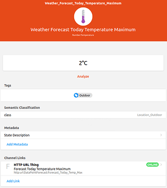

I then created an Item to hold this data:
The YAML for the State Description field is as follows, formatting as an integer:
value: " "
  pattern: "%d"

I started migration yesterday - and yes using UI is very intensive.
I had a few other problems on migration I needed to resolve.
I can much more easily adapt what you have done above esp as my items are already defined in file - just needs a change to add the channel.
At some point datapoint is being turned off. Need work on a solution for that
They’ve been threatening that for well over a year, but it will be replaced by the unknown DataHub.
Yup - registered for datahub - cant access anything though.
Had a few problems with your code - my openhab didnt like MAP on the channel - so I stuck it on the sitemap…or the item now all is well
Interesting.
Is the MAP Transformation Service installed - presumably yes, because it works on an Item? Someone yesterday had an issue with a Transformation Service not being recognised, but uninstalling and reinstalling the Transformation Service worked!
Both are installed - Jsonpath is giving me the info
MAP is working when used elsewhere just not as you have used it
