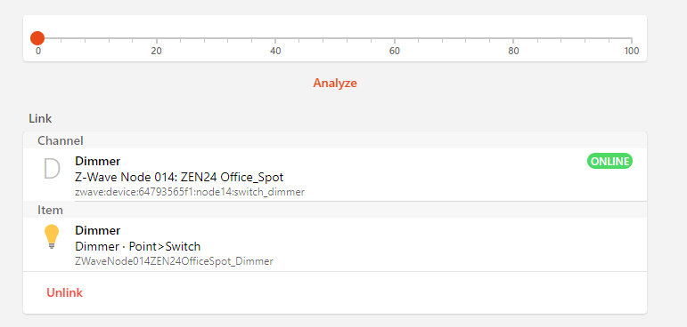

OH3 Z-wave ZEN24 Dimmer not updating channel state
Yes, those channels are all linked to Items in the same way as the other dimmers that work properly.
When I first installed the ZEN24 devices a few months ago, they weren’t in the z-wave device DB.
I collected an XML, uploaded to to site, and @chris added it to the DB.
To be honest, once I got Items controlling the dimmers I never noticed the device wasn’t updating the channel state.
In searching the forum I see others reporting a similar problem,
