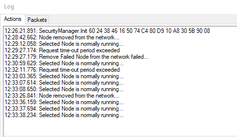

Update:
Using the zensys PC Controller, it thinks my devices are present and working. they are not.
The tool will not allow me to make as failed or remove them.

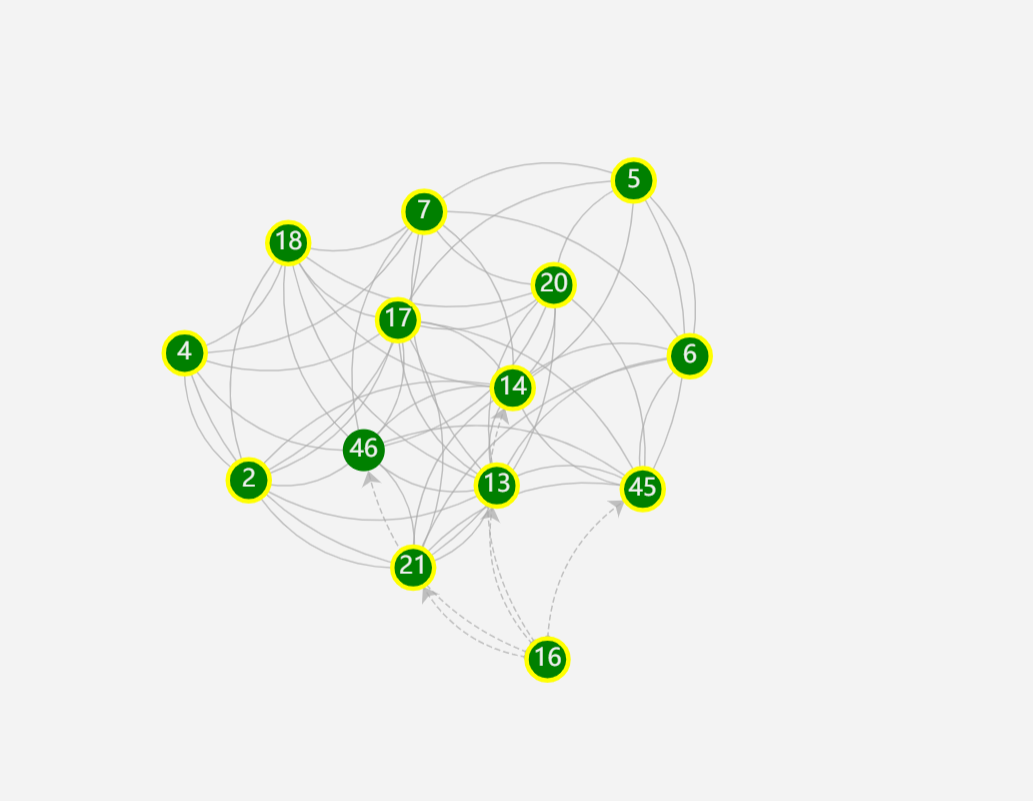

I can’t tell from the PC Controller log if you are first clicking the (check) If Failed, then the Remove Failed but that is the order to remove a Node. Also, although I can’t say how, but possibly the same device is under two different node numbers. Can you look at the network section (with the node listing) and look through the properties?
Lastly with the ratio of zombies to working, a possible (but Nuclear) course of action. Exclude all the devices that you have working using the UI Controller page to “Exclude devices”. Reset the Zstick to factory defaults (to clear the 7 zombies) and start afresh. With mainly powered nodes reinitialization should go quickly. I do recognize that electrical wall plates might have to be removed to press an “action” button to both exclude and include again.
I actually find zwave and the binding quite stable (50 nodes, 13 battery), but also have a zniffer so can see routing problems right away. Your problem is routing, not the binding.
