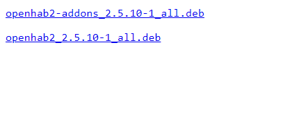

I guess it isn’t intentional that only the openhab2-addons package is new but openhab2 remains at 2.5.9 ? @benjy any issue with the upload or repo ?
[23:56:10] root@openHABianPi:/home/openhabian# apt-cache madison openhab2|head
openhab2 | 2.5.9-1 | https://dl.bintray.com/openhab/apt-repo2 stable/main armhf Packages
openhab2 | 2.5.8-1 | https://dl.bintray.com/openhab/apt-repo2 stable/main armhf Packages
openhab2 | 2.5.7-1 | https://dl.bintray.com/openhab/apt-repo2 stable/main armhf Packages
Same here after update 2.5.9 is shown in webinterface, addons are updated to 2.5.10…
Running on openhabian.
Seems that Dashboard is still on 2.5.9:
openhab> bundle:list | grep 2.5.9
384 │ Active │ 80 │ 2.5.9 │ openHAB UI :: Bundles :: Dashboard UI
Also in Karaff Shell:
Logging in as openhab
                               Release Build 2.5.9
The update seems not to be available in the repos. Tried to update it via apt-get on my ubuntu server.
Hi, now 2.5.10 is on the repo, but not offered with apt upgrade:
sudo apt upgrade openhab2 -s
Paketlisten werden gelesen… Fertig
Abhängigkeitsbaum wird aufgebaut.
Statusinformationen werden eingelesen… Fertig
openhab2 ist schon die neueste Version (2.5.9-1).
Paketaktualisierung (Upgrade) wird berechnet… Fertig
Hey guys, sorry for the issues. The CI build of the linux-pkgs is somewhat unreliable…
I have re-triggered everything, including re-calculation of metadata. I’d hope that this has solved the problem.
@Kai: I can confirm, that after starting update again now everything is running in version 2.5.10.
Also shown in karaff shell and web Interface now.
Many thanks for you support!
