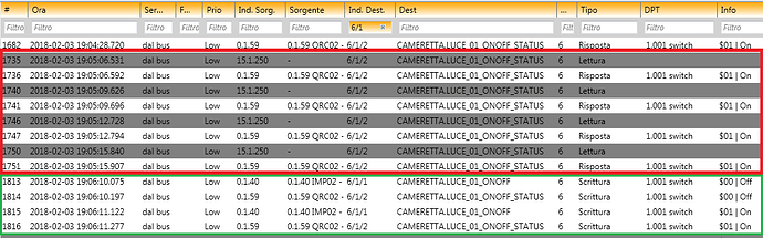

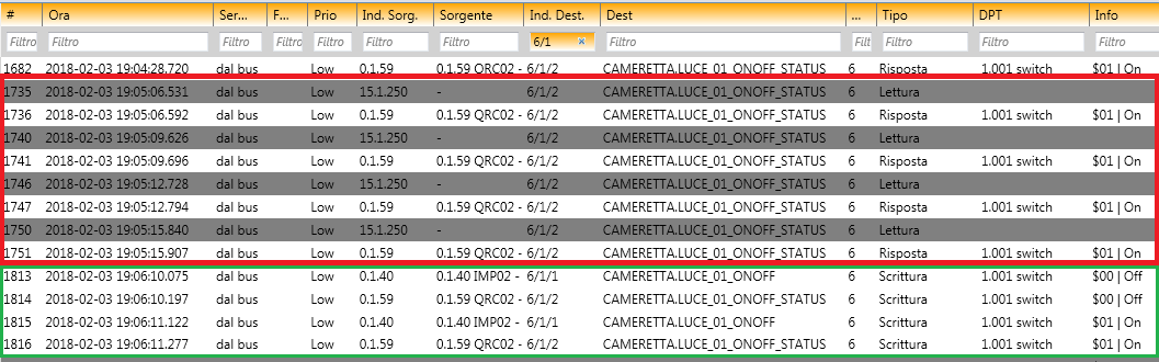

If I press a KNX switch to turn OFF or ON the light openHAB receives correctly all the updates (last 4 lines in log)
Also, the ETS monitor shows:
Every openHAB reading attemp, I can see in ETS monitor a message from OH (15.1.250) to the bus, and and immediately after a answer is been sent by the KNX bus.
With one-item configuration this warning could be ignored, but for a large knx installation openHAB become very very slow (means unusable..) to update all items at startup. OpenHAB log is spammed by these warnings continuously.
Is anyone else using KNX facing the same problems?
