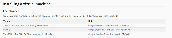

Apparently, as expected the Gentoo wiki has the answer.
from Java - Gentoo wiki
This is not a Gentoo question. If I want to have Java 8 as system vm, it should be possible to run a Java application with a JDK 11 that is extracted somewhere. At least, this is possible with every other Java application and there should be no need for docker etc.
