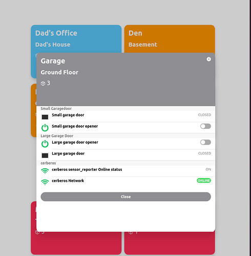

If you create a model for your Items than the locations, equipment, and properties tabs get automatically populated based on how your Items are situated in the model.
The above screenshots show the locations page and my Garage room. Nothing shown has any customization and were put on the page automatically. All I had to do was create the model in the Model tab. Personally, with the “add equipment from thing” and “add points from thing” options, I hardly ever need to mess with the Items page directly any more. I do it all from the model.
If you want to customize how those automatically generated UIs look, you can define the widget that gets used for a given Item on the Item itself on the Item’s page.
