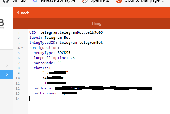

Look at the chatIds parameter (a List<String> or multiple text).Why are two values enclosed in double-quotes and one value is without quotes?

The YAML stringifier will add double-quotes automatically for strings where there might be an ambiguity on their type, the < character is probably key here, the other values could maybe be considered to be numbers so it added the quotes.
Is it possible to change that? I think that is not very clear.
Don’t think so: YAML - there’s no option related to that as far as I can tell.
(edit: maybe str.defaultType here YAML)
More info on using quotes in YAML: Quoting - Learn - yaml.info
