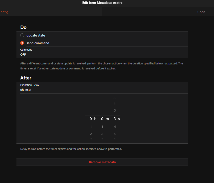

did expire make it into this one?
Yes you add it to item as metadata
