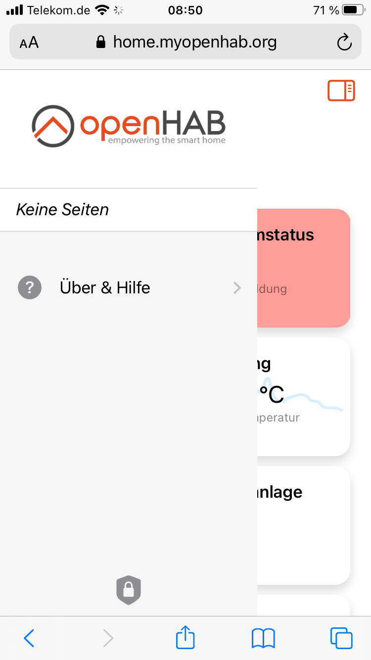

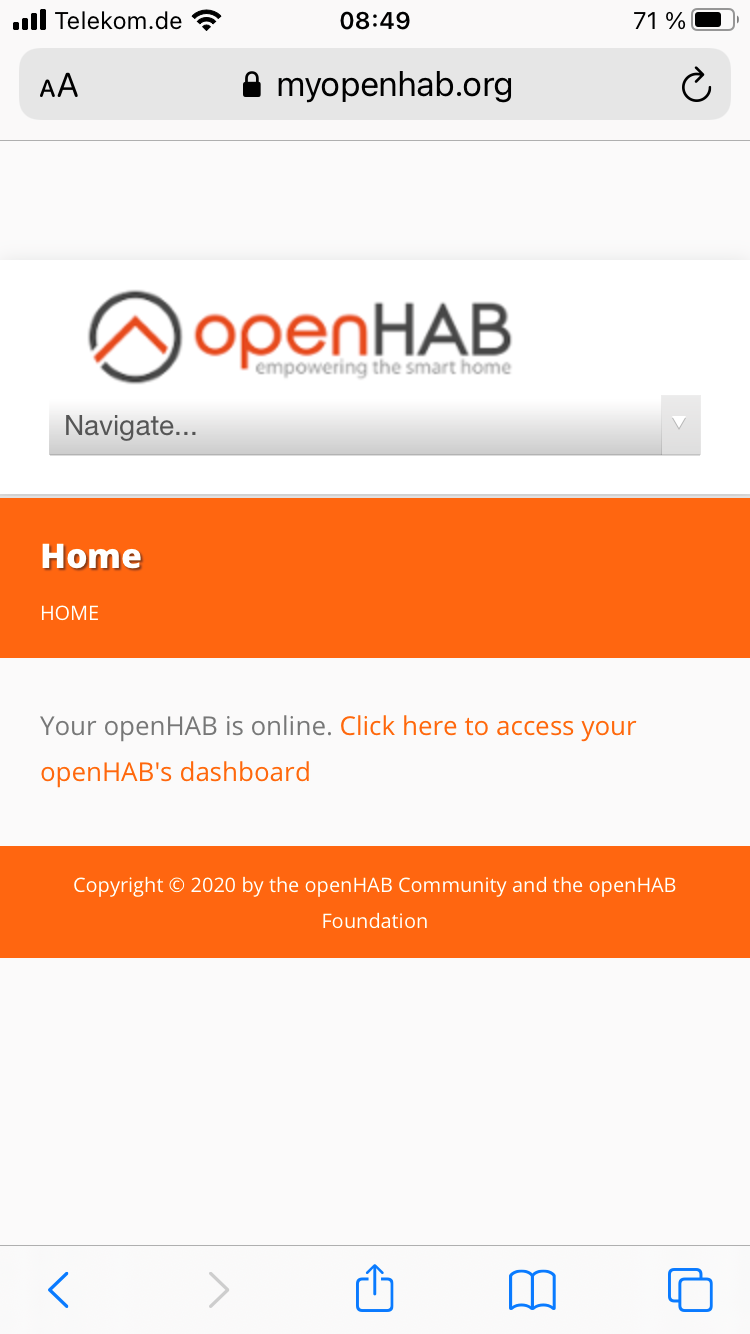

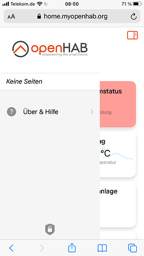

In Safari, go to
home.myopenhab.org
and sign in, you should now see the following:
Click to access your dashboard should lead you to your openHAB

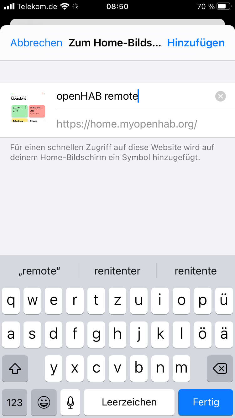

Now add it to your homescreen
Only Culprit by using it this way, you won’t have the nice icon. But this will be implemented later within the app.
If this does not work for you, then there is something wrong within your installation.
