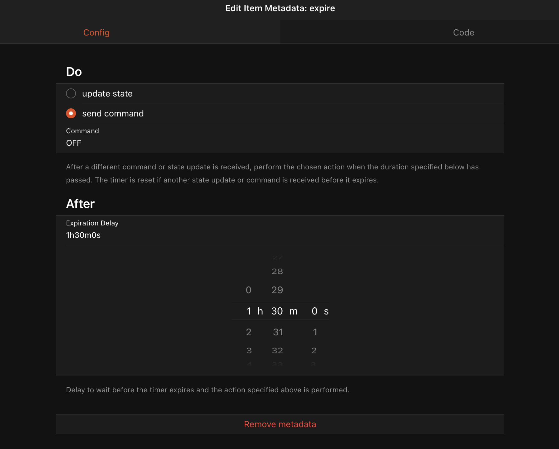

I would like two Items to automatically turn OFF after 1h0m0s, and one Item that needs to automatically turn OFF after 1h30m0s.
I defined the Items in OpenHAB and added the Metadata for the Expiration Timer, but the Items don’t turn OFF when the timer was supposed to finish.
The weird thing is, I tested all three Items configured with an Expiration Timer of 0h5m0s and the three of them turned OFF properly.

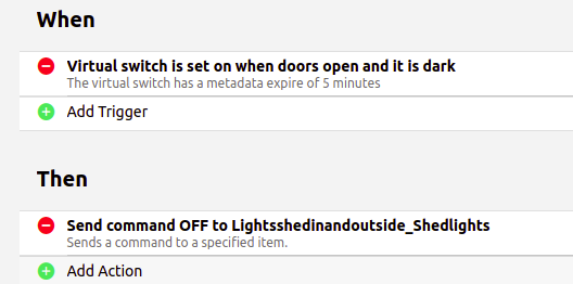

You can still use the expire if you set up a virtual/dummy switch as it will not be affected by the z-wave updates.
I use this method all the time.

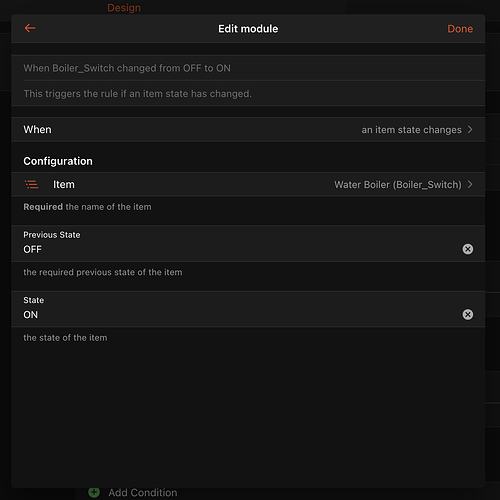

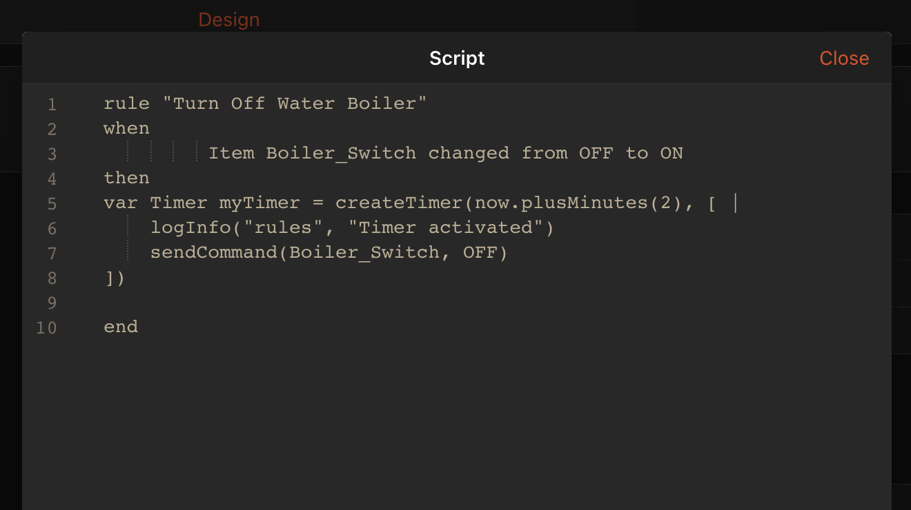

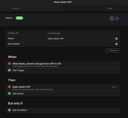

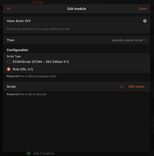

Can someone suggest how I should go about writing a script in the UI Rule creator?
Previously, when I used OpenHAB 2.5.11 I had a rule file (in /etc/openhab2/rules) for automatically turning off the water boiler, but when I paste the full text I had in the file into OpenHAB 3.1 Rule DSL (v1) it does not work.
Am I doing something wrong?

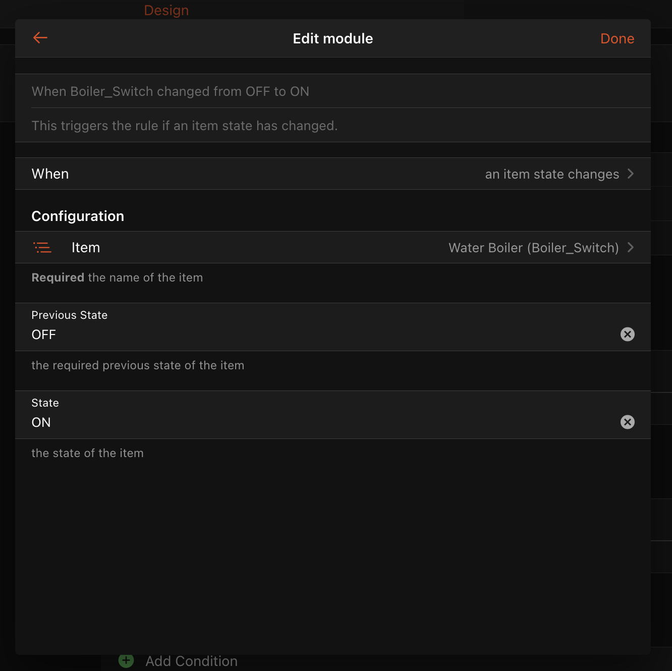

I’m not sure because not using OH3 yet but I think in a UI create rule, you don’t put the ‘rule’ ‘when’ or ‘then’, you only paste into the script box the portion of the rule between then and end
the UI takes care of the when part and rule name ect.
You just need the code for the then part as you have already coded the event of when changed from off to on in the UI.
Or if you are comfortable using text rules, continue to use text rules. Paste the whole show into a xxx.rules file and stuff works as it did in OH2.
This worked. Thanks for the tip :slight_smile:
