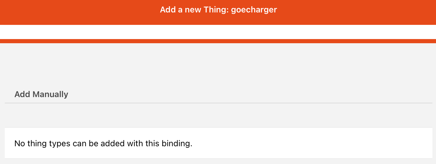

However I am using the latest image from docker hub (3.3.0-snapshot-alpine from Today (April 27th)) which for the sake of completeness I post this here as well, just in case it could be a version-related Issue after all.
As I couldn’t find anything regarding this:
Using the latest snapshot-alpine in docker works but for the go-e charger binding. The already created things work and all linked items also but I can’t create new things (“No thing types can be added with this binding.”):
I’ve already cleared the cache and reinstalled the binding resulting in exactly the same situation.
Anything I can do about it?
EDIT: Seems to be known already: Go-E Charger Wallbox Binding - #99 by kreutzer_peter
