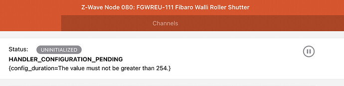

My fibaro Roller shutter 3 stopped working after updating to M8.
It says
`HANDLER_CONFIGURATION_PENDING
{config_duration=Der Wert darf nicht größer als 254 sein.}`
(the value is not allowed to be over 254)
But I have no idea which value to change.
Any idea, @chris?

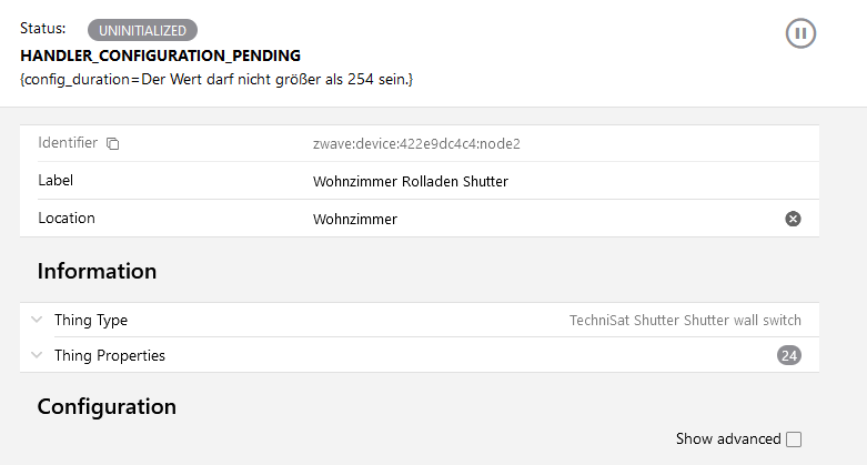

Hello together,
I have the same problem here with Technisat and FIBARO roller switches.
I think it will be related to this -:
            <parameter name="config_duration" type="integer" min="1" max="254">
                <label>Step duration</label>
                <description><![CDATA[Sets the dim rate speed<br>Values from 1 to 127 are defined in seconds,
                while values from 128 to 254 are defined in minutes.]]></description>
                <default>255</default>
                <options>
                    <option value="255">Device Default</option>
                    <option value="0">Change Instantly</option>
                </options>
                <limitToOptions>false</limitToOptions>
            </parameter>
This is the config parameter that the error relates to, but this definition looks ok to me so I’m not sure what it’s complaining about unless the value is outside the allowable range of less than 0, or greater than 255. Can you check this to see what it’s set to? The default is 255 so this should be ok unless it was changed.
I was not able to find “Step duration” in the UI, also it was not defined in the Code panel of the Thing.
After adding config_duration: 255 to the Code panel it is working again.
I had not touched its config for at least some months and it worked fine until I did the update. Looking at the commits in the zwave-repo I don’t see why anything should break from these.
Note that this is channel configuration - not thing configuration, so you need to look in the channel for this configuration setting.
Hi Chris,
I have the same issue on several Things, e.g. the following
The configuration is as follows:
UID: zwave:device:7175b6a970:node80
label: "Z-Wave Node 080: FGWREU-111 Fibaro Walli Roller Shutter"
thingTypeUID: zwave:fibaro_fgwreu111_00_000
configuration:
  config_34_4_0000000F: 0
  config_11_1: 6
  config_31_4_0000000F: 0
  group_1:
    - controller
  group_3: []
  group_2: []
  config_153_1: 1
  config_152_4: 150
  config_154_2: 10
  config_155_2: 10
  config_150_1: 0
  config_151_1: 1
  config_12_1: 0
  config_32_4_0000000F: 0
  config_13_1: 100
  config_156_4: 6000
  config_35_2: 600
  config_157_4: 6000
  config_41_1: 0
  config_65_2: 10
  config_62_2: 3600
  config_61_2: 15
  config_40_1: 0
  config_60_1: 0
  config_33_4_0000000F: 0
  config_30_4_0000000F: 0
  config_24_1: 0
  config_25_1: 0
  config_66_2: 3600
  node_id: 80
bridgeUID: zwave:serial_zstick:7175b6a970

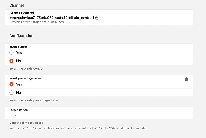

Here is the channel config:
Changing it to 254 put the thing into online again.
I am wondering why this only now appears? Did you only implement that check now?
Does anyone know what the “Step duration” is for?
Cheers
Stefan
The problem relates to the rigorous checking introduced in 3.3M2. Since this is handled by the core, it is not a zwave issue. What needs to change is this in the DB? (edit: Actually I do not know where this needs to be changed) (change 254 to 255)
The 254 is being picked up by the checker as max, even though the default is 255. I had a similar problem with a different device where the default was outside the range the checker checked. (if that makes sense?)
Bob
Can you link to the file where this definition is made. In case 255 has a special meaning (and is outside of the defined range 1 to 254 it should be added as <option />. If this is the case and the check fails, it’s a bug in the checker.
I’m afraid I can’t. I don’t have the device and could not find this xml fragment. I just recognized what was going on from an earlier issue (3.3M2) that I fixed with a Z-wave DB edit.
Might have to wait for morning in NZ, unless one of the folks that have the device know.
Sorry
Bob
Had a brainstorm. File location is in the Zwave binding. Still don’t know if 255 has a special meaning, though.
src/main/resources/OH-INF/thing/channels.xml

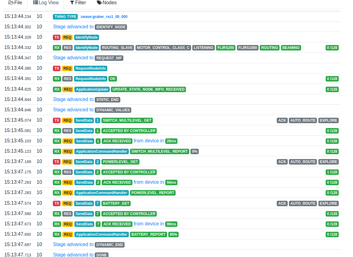

I just updated to M7
All of my Bali zwave shades failed to initialize
here a zwave log for one shade
any suggestions?
If there is the “handler” message, it is related to the last 24 hours of posts directly above yours. The quickest thing will be to edit the channel to 254 step duration (edit: based on subsequent posts setting to 254 would fall into the “bad idea” category :wink:), pending either a validator change or binding change.
Bob
