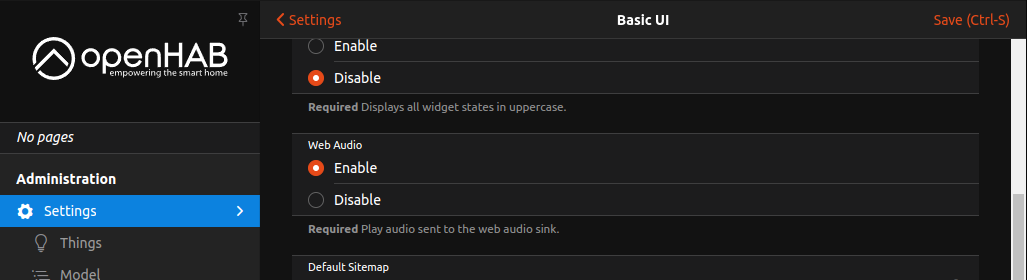

Before it will work you first need to enable Web Audio support in the Basic UI settings (and reload any Basic UI):

PS: for Basic UI, there is also a separate setting to enable/disable Web Audio in Basic UI (independent of Main UI setting). Web Audio in Basic UI was just merged today and so is not part of 3.4 milestone 1.

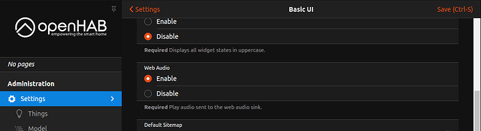

I mean the settings refered to her:
My openHAB settings are correct, since the audio is played on my PC browser. So I have no idea why I can not get it working on Android or Firefox.

Sorry, I don’t find the page containing these settings !!!
