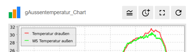

After upgrade to 4.1.0 M1, I have title bar above every chart in a sitemap:
There is no icon or label set.
Is there any possibility to get rid of this bar?
You can’t get rid of this bar (the icons at right) but you can avoid the icon and the label by adding label=“” and icon=“none” to the sitemap chart element.
PS: your icon and label are probably coming from your group item (if not defined on your sitemap element).
PS2: your legend icon should be colored as I see the legend in your chart. Maybe a bug…
icon="none" did it. I tried icon="".
There is no label or icon set for the group item. Neither in the icon definition nor in the sitemap. So the name of the group is displayed.
That is OK now. May be there had to be a restart of the browser. Just found a little typo. :wink:

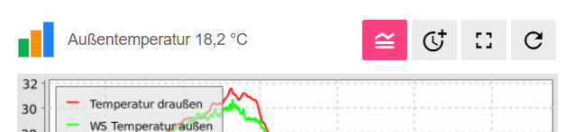

Would it be possible to set an item value as label to get something like this?
And then you get the default icon associated to the sitemap element.
I will fix it,
The value of the item linked to the sitemap element (group item value if you linked to a group item) ? That is a possible enhancement but note that on a phone, with the 4 buttons at right, we have not a lot of place to add a new data (value).
I’m thinking about the value of any item. It must not stay in relation to the group or item of the chart. Something like label="Außentemperatur [WS_Temperatur_aussen]"

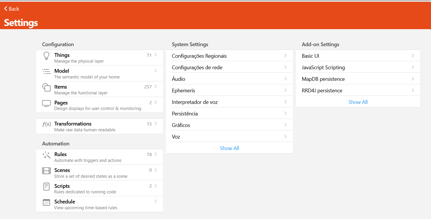

Regional Settings: I have Firefox parametrized for portuguese and openHAB 4.1.0.M1 parametrized for english. Nevertheless MainUI takes a mix of both languages in some screens, such as this
