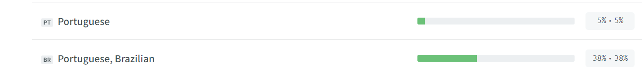

I am guessing that nobody has yet provided the Portuguese translations for those texts on CrowdIn https://crowdin.com/..

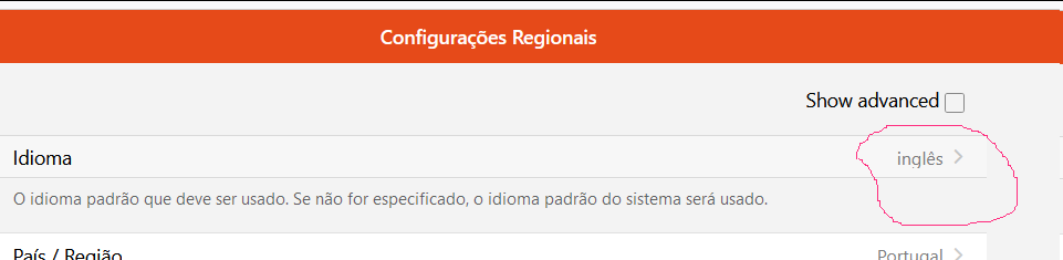

Well, I can do the translation. But I think that OH should pick the OH regional setting and not the Firefox one, or am I wrong ?
I think it takes the browser setting. Reason would be that different users may have different preferences on different devices.
See also: Change UI Language does not work
Seems a bit weird to use the browser language. It’s not consistent behaviour with web sites where you have an option to select the language. I have specified english language in regional settings but the UI is partially in portuguese.

I totally agree with you, I already brought up the question here: Language setting only partially respected
And I got the same answer, but it’s really not an intuitive feature
