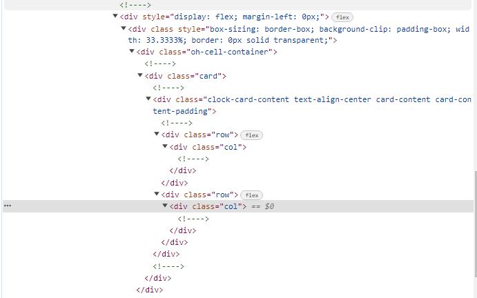

Since installing M2, the oh-clock-card widget no longer displays any content for me. The frame is simply empty. Has anyone else observed this as well?
I am seeing the same. With Inspect I get:
