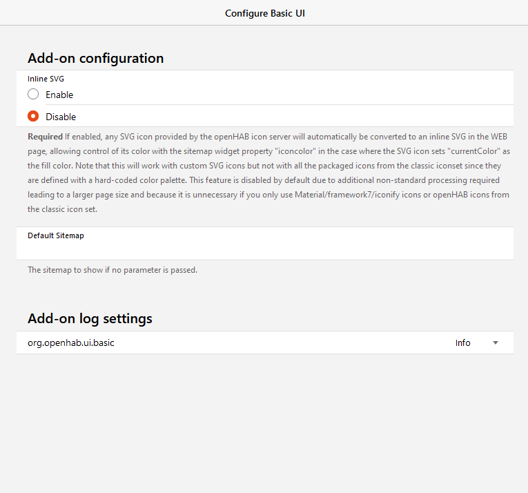

Another issue observed. BasicUI was reverted to 3 columns. Before it was set to 2 colums.
Cannot change it because setting are unavailable:
Settings → Add-on Settings → BasicUI
The settings are now on the basicui screen itself. It’s a cogwheel icon on top left. The settings are now configurable per-browser instead of centralised.
