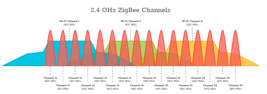

Well…another big issue I realize… the Hue system is ZigBee-based… and this will directly interfere with normal 2.4Ghz WiFi. Yikes. I have Ubiquiti Unifi WiFi Access Points throughout my house… and if I add any ZibBee stuff… they will directly interfere with my WiFi.
WiFi’s three non-overlapping channels (1, 6, and 11) use the exact same frequencies as ZigBee channels 11-22. I’ve now read that ZigBee channel 26 is usually relatively unaffected by WiFi, but many ZigBee devices do not support it.
Can you specifically select the frequency (ie Channel 26) to be used by these ZigBee Hue sensors?
I’m not sure I want to get into the issues of my WiFi not working or the Hue stuff not working reliably… Hmm.
What is the experience out in openHAB land of mixing ZigBee and WiFi???
thanks
Dave

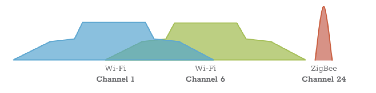

Definitely an interference issue when installing ZigBee in a standard 802.11n (2.4 Ghz) environment. Hmmm. I think it will be only safe if I can force ZigBee Channel 26 to be used.

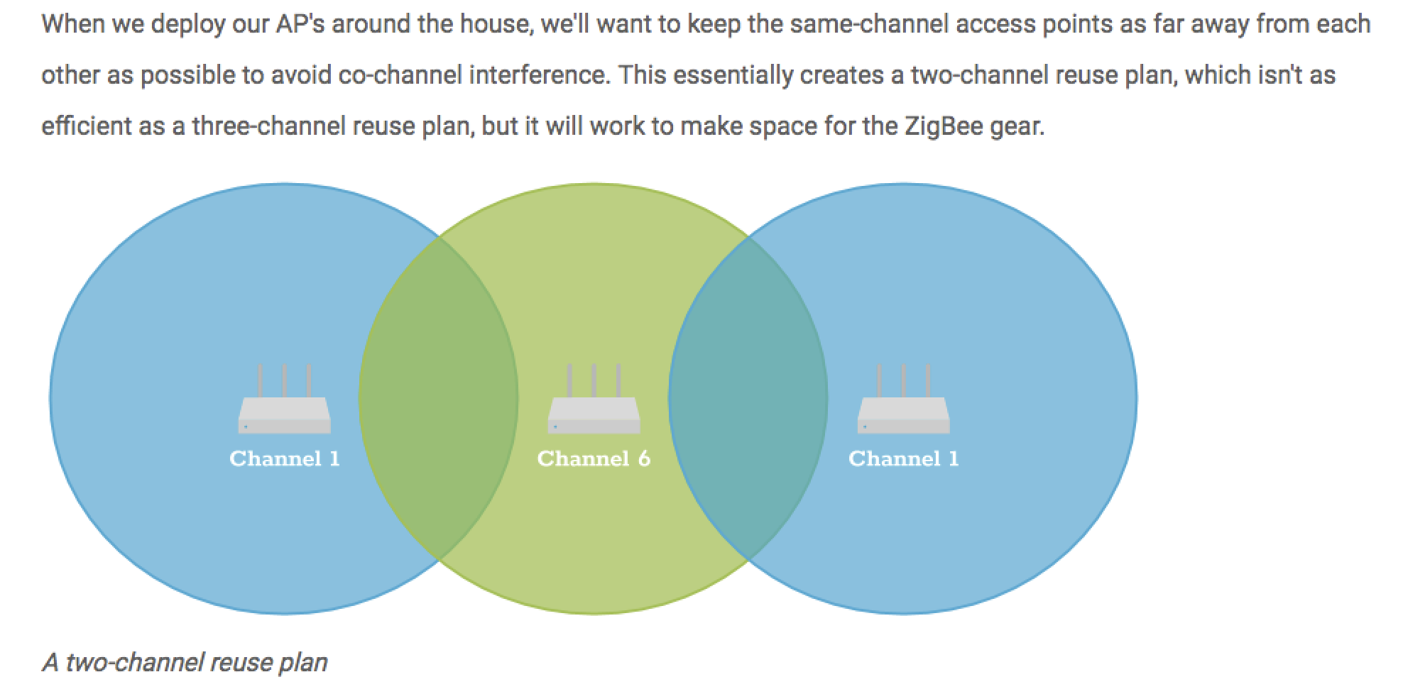

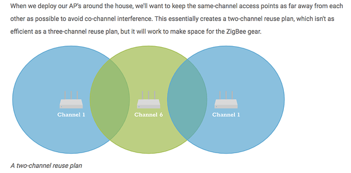

I know in my setup, I am using WiFi channels 1, 6, 11 for my 3 Access Points, which provide excellent WiFi coverage throughout. I am very hesitant to disable one of the channels and have to go to something like this:
So I am curious about how others make ZigBee work properly/reliably with WiFi.
