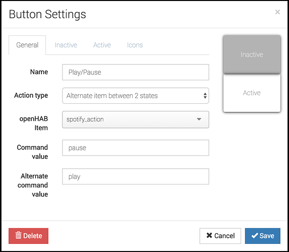

If you do not want to use a custom widget but directly take habpanel widgets you would have to use a “button” widget and set it to fire (alternating) events to item spotify_action. See this image:
However I would suggest that to use a custom widget, for example the Music Control Widget, and connect it to the right items (spotify_action, etc.).

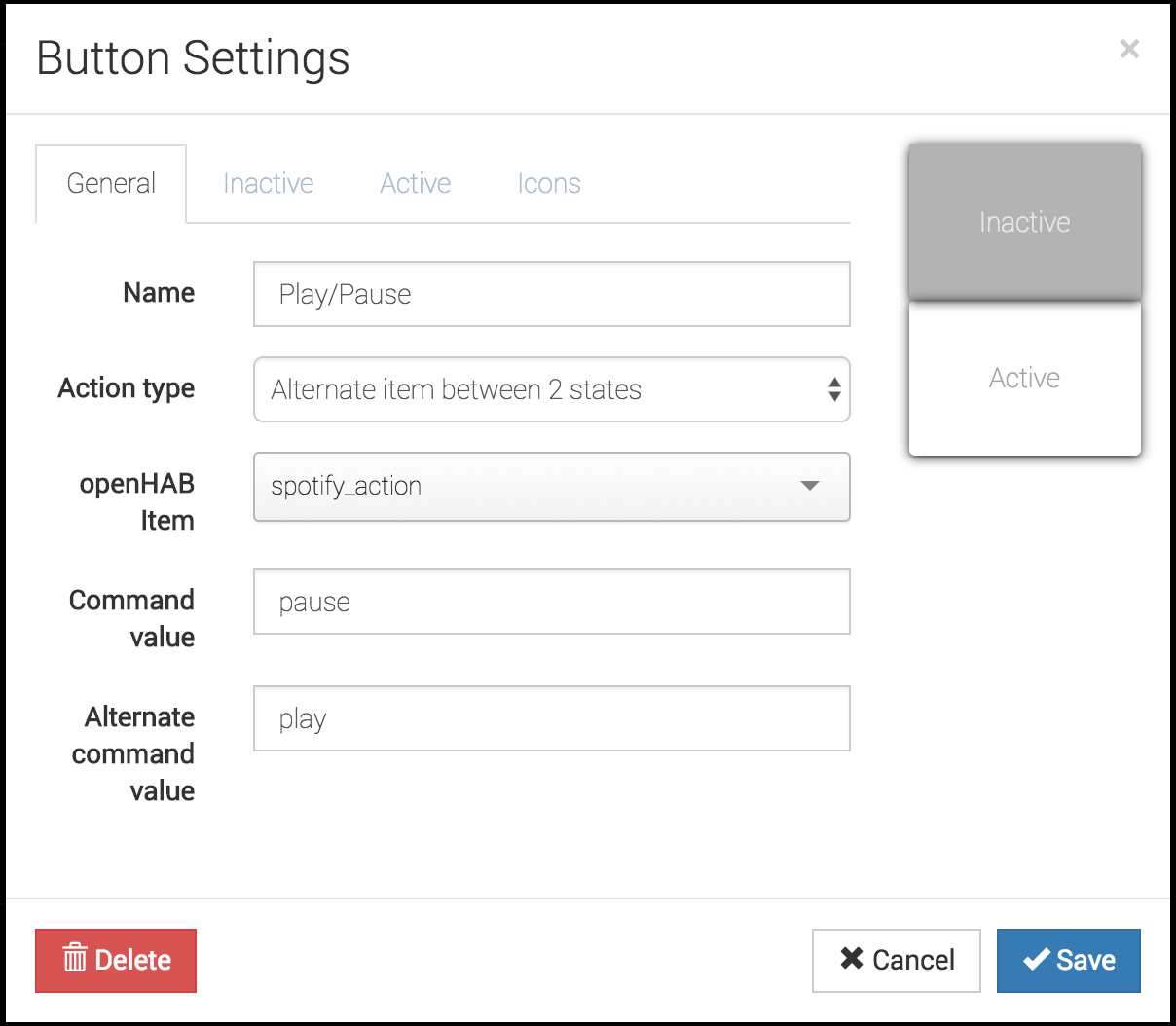

For the other guys:
just send commands to the spotify_action item like:
play pause etc … you don’t even need to code, you can just use a button widget for example.
