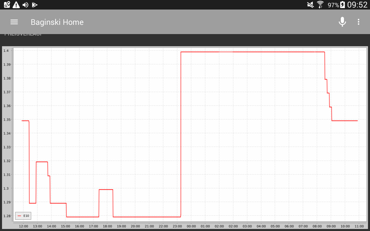

Are we all prepared for this tonight? The clock is turned back again to match wintertime. At 3 o’clock in the morning. The issue in ESH hasn’t been closed, yet. What will await us this time?
Just to give you any feedback. I faced no problems this time.
No problems here as well, the chart even shows correctly 2o’clock two times.
