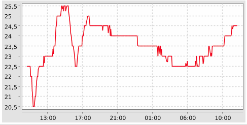

Next shift to DST, old problem again.
It looks like the shift from DST to normal worked (as reported in Oct’17) however tonigth shifting to DST again rrd4j stopped again.
I’m running on OH1.2 (rrd4j 1.11.0)
The binding reporting the values (in my case Tankerkoenig) is confirmed working.
Checking the rrd4j with the REST API: A Persistence/Get request showed the rrdj, however the reguest for persistence/items/itemname gave a 400.
Stopping and Starting the bundle did resolve the problem.
Would be great if this issue is checked and eventually resolved.

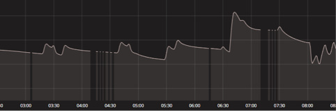

Old issue also exists with InfluxDB. (RPI3, OH2.2, InfluxDB 1.4.2)

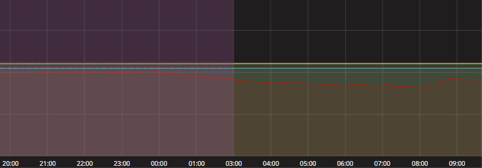

Data from MQTT sensors is stored intermittently: (strategy = everyChange, everyMinute)
Data from Homegear ( strategy = everyChange, everyHour, everyMinute) shows set temperatures are unaffected, wall thermostat was not affected but valve position data dropped out at 3:00 AM.
However, for another wall thermostat there was no data recorded after 3PM.
I did a full re-boot to recover (did not try restarting openhab).
