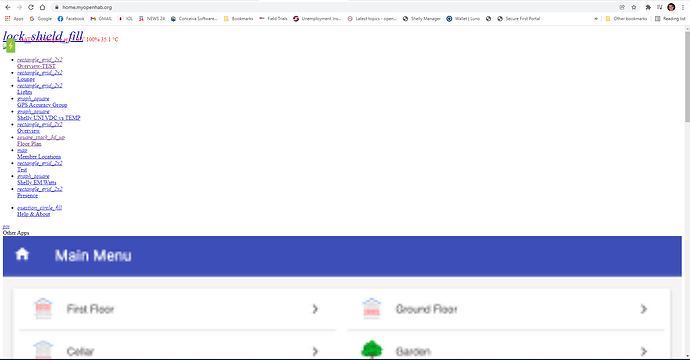

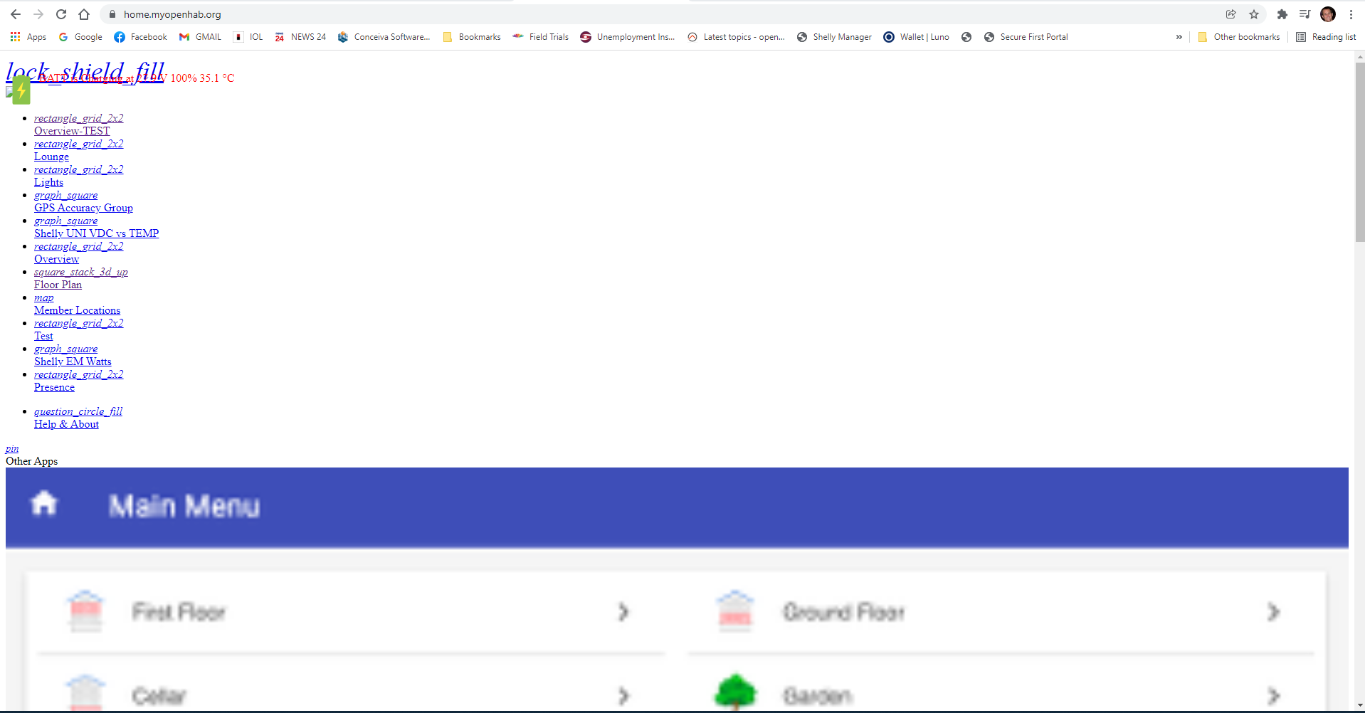

EDIT: Got screen shot of incomplete page:

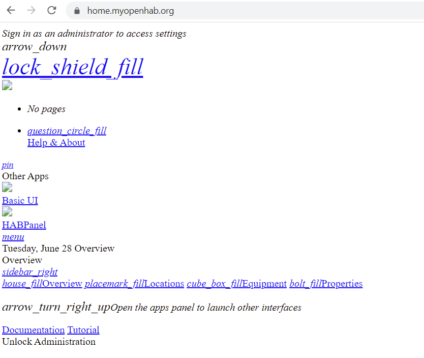

So hoping someone has an idea.. I just upgraded to 3.3.0.M6 and myopenhab.org shows online, cloud connector looks fine from the debug log and shows activity but home.myopenhab.org shows blank and the android app, both regular and beta, shows empty sitemap or “error to display UI” when via cloud, when local, it works fine. the cloud connector works great for my OH2.5 instance but wasn’t going to fully migrate but thought it was something I had going but seems to be a greater issue observed by others.
My log with it set to DEBUG:

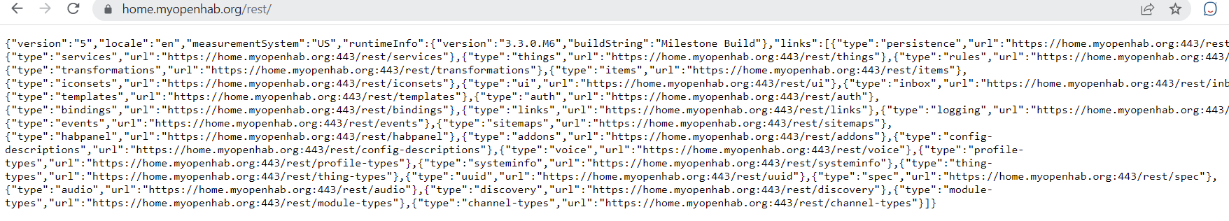

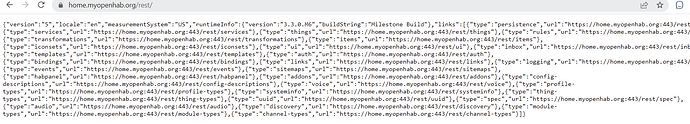

and home.openhab.org/rest/ seems to show but main page to access dashboard is blank:

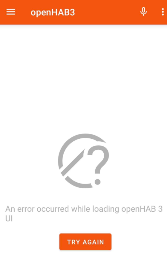

When accessing via the android beta app:
Log for that activity:

Anyone? I see various things in git but I still can’t get myopenhab.org to work with OH3. dashboard is blank there too. Sometimes it comes up half way. The android app on the brand new install to test sometime comes up after refreshing 5 or 6 times. No issues on my OH2 install. Anyone have an idea here? I’m banging my head into the desk on this.
when it sometimes loads something.. it’s not formatted right:
and Android app, both current and beta, all do the exact same no sitemap.. hit retry multiple times and it seems to load the sitemap .. sometimes. Thoughts?
