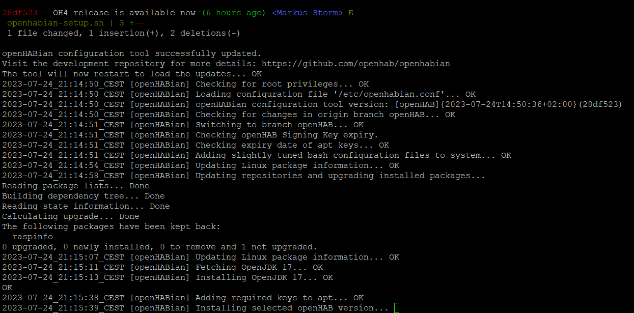

Openhabian: Update to OH4 FAILED (fetching Java17)
Trying to upgrade to OH4 from 3.4 but failing. I’m running Openhabian and it fails via System Upgrade as well as via Install as via trying to install Java 17 via menu option 4* (whatever number that is).
Attempts via APT fails as well and attempts to manually install Java 17 w APT fails pointing at dependencies to ‘libc6’ >= 2.34, where I only have 2.28. Manual attempt at THAT package comes up empty.
Has something changed very recently causing a general issue with Openhabian and Java17-installation or is there something fishy with my system? Any ideas on how to get the correct Java onto the Pi? :slight_smile:

  • Issue of the topic: Trying to update OH 3.4 to 4 via ‘Openhabian-config’. Fails at “Fetching OpenJDK 17”
APPARENTLY I was still on Buster. I was absolutely sure I was on Bullseye since ages (I did a restore a while back and that backup was probably older than I thought). Will re-attempt post-upgrade, but feel pretty sure that this is related to Buster availability of packages.
Issue persists following upgrade to Bullseye. Neither myself nor Openhabian seems capable of getting Java17 on to the system. Trying to get it manually installed.
Having tried to get around this and failed in spectacular fashion, I surrendered and made a fresh install with Openhabian and then restored settings to it. Worked flawlessly and I am now running 4.0. Will mark as closed!
