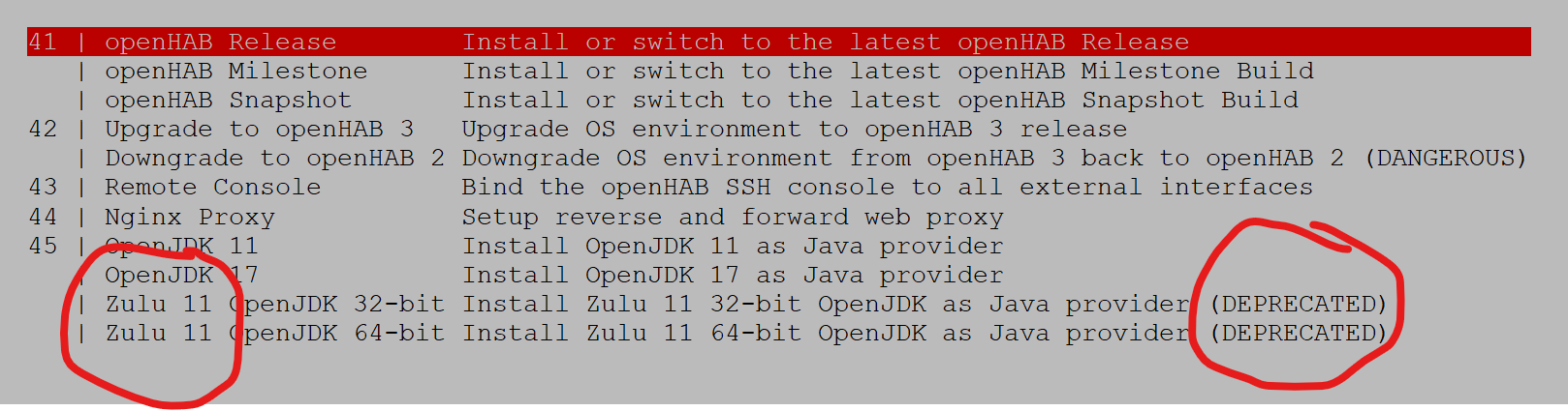

Ok. I probably misinterpreted this:
and the changelog of openhabian:
Major Java provider switch ## December 15, 2021
We have switched to supporting only the OpenJDK package provided by default from
the APT repo for all new installations of openHABian. Existing installations
will be unaffected, however you will no longer receive updates to your current
Java install until you install Java from the new provider which you can do by
running menu option 45.
That’s why I moved to OpenJDK 11
Was not aware of this options as I don‘t use openHABian.
Unfortunately it is not possible to revert back to Zulu 11 by menu option. Going back manually now and see if the problem persists.

The release notes say OpenJDK for new installations. I assume that a few more users are irritated by that deprecated flag

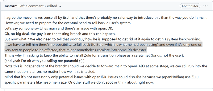

See github: Change Java providers and add support for Java 17 by ecdye · Pull Request #1632 · openhab/openhabian · GitHub

Just for completeness: reverting back with openhabian config menu is not possible.
EDIT:
well, haha, somehow Markus saw that coming up

Fixed, use openhabian-config to revert and it should work now.
