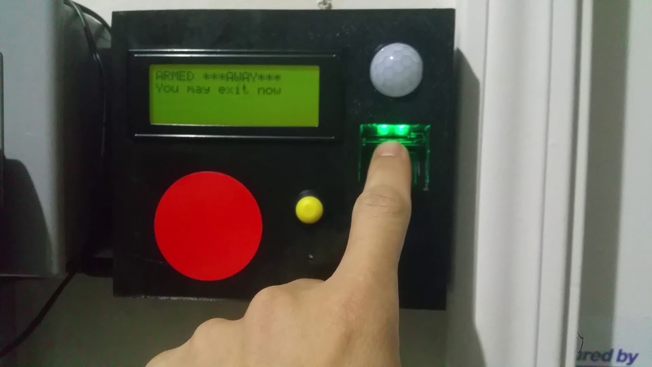

But here’s another keypad I made w ESP32, with rfid reader and fingerprint sensor. What you see on that little screen is exactly what shows on a real alarm keypad (Honeywell vista)
That’s very nice indeed, thanks!
It looks very nice! Would you happen to have some documentation on how you created it? Sources in a github repository for instance?
