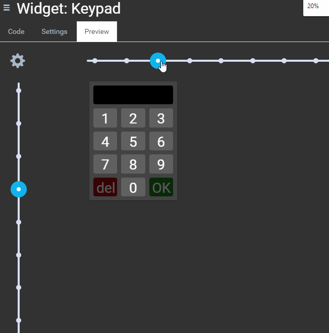

Demo
openhab_widget_keypad
Responsive
openhab_widget_keypad_responsive

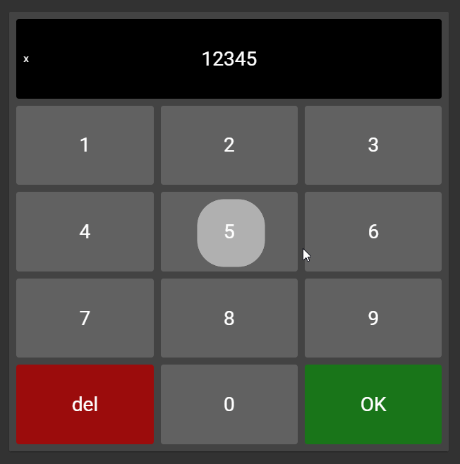

Stylable
openhab_widget_keypad_styles

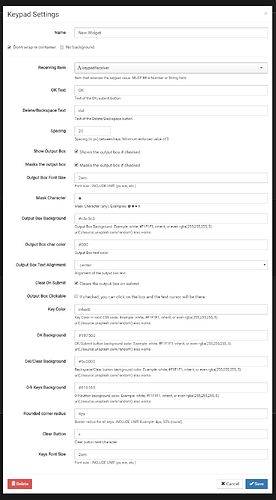

Settings
Settings are self-explanatory so I will only provide comments on the ones that are not straightforward.
  • Mask Character - this will mask the output box
  • Clear on Submit - if this is checked, the model is also cleared. This will NOT clear your item, only the UI client side.
  • Output Box Clickable - if enabled, you will be able to click on the box just like an input box.
  • Units - Some of the settings require UNITs so do not forget to include them.
  • Background - You can set using any CSS-valid value. Examples:
    • url(‘//path/to/an/online/image’)
    • inherit
    • black
    • transparent
    • #FFFFFF
    • rgb(0,0,0)

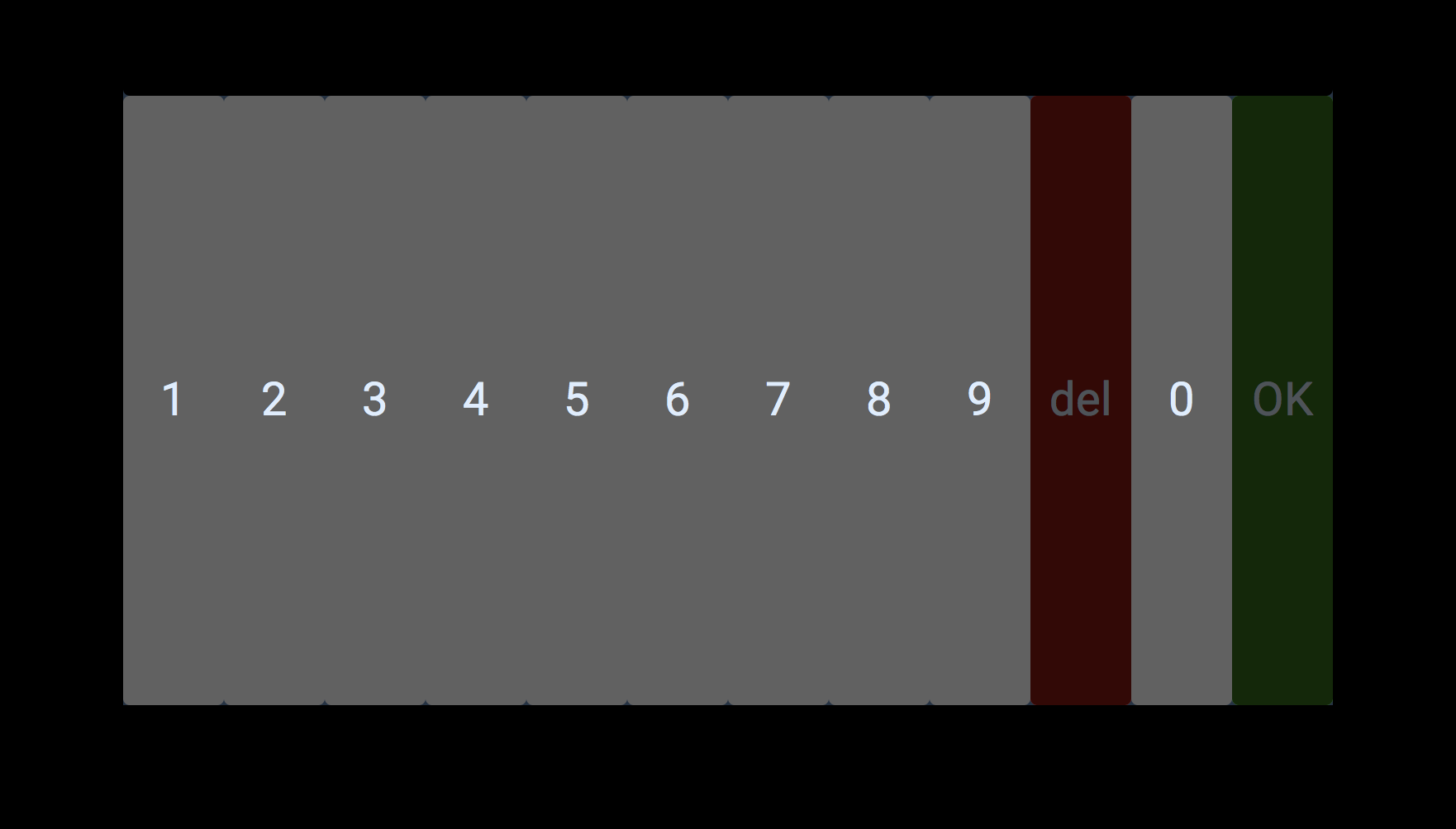

I would like to use this widget but I have some layout issues (see picture). I have the same result on latest versions of Firefox, Chrome or Safari on Mac.
Any idea on how to fix that ?
All settings are default, except the checkbox to avoid putting it in a container.
41
I’ve the same problem as @tarag.
Do you have a solution for that?
Can anyone provide some code that when pressing an existing switch widget it would then pop this keypad up as a prompt to enter a code and then on OK it closes the pop up?
It looks like this if you leave “Spacing” empty. As soon as you fill this field - even if it is zero - it shows the keypad layout with three rows.

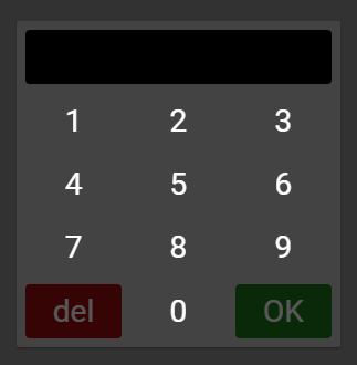

I installed this widget and it works great. Thanks for the hard work. There is a problem: when the page is viewed in a mobile device, in portrait mode, the rendering is not correct. Can anyone tell me how to fix this?
In landscape mode:
In portrait mode:
Thanks!
