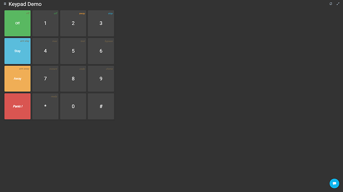

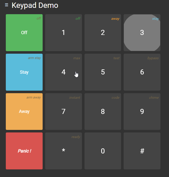

Alarm Keypad with multiple settable Items
Features:
  1. 0-9 Keys
  2. Single key Arm Away
  3. Single key Arm Stay
  4. Panic button
  5. Every key press is sent to item immediately
  6. Customizable text

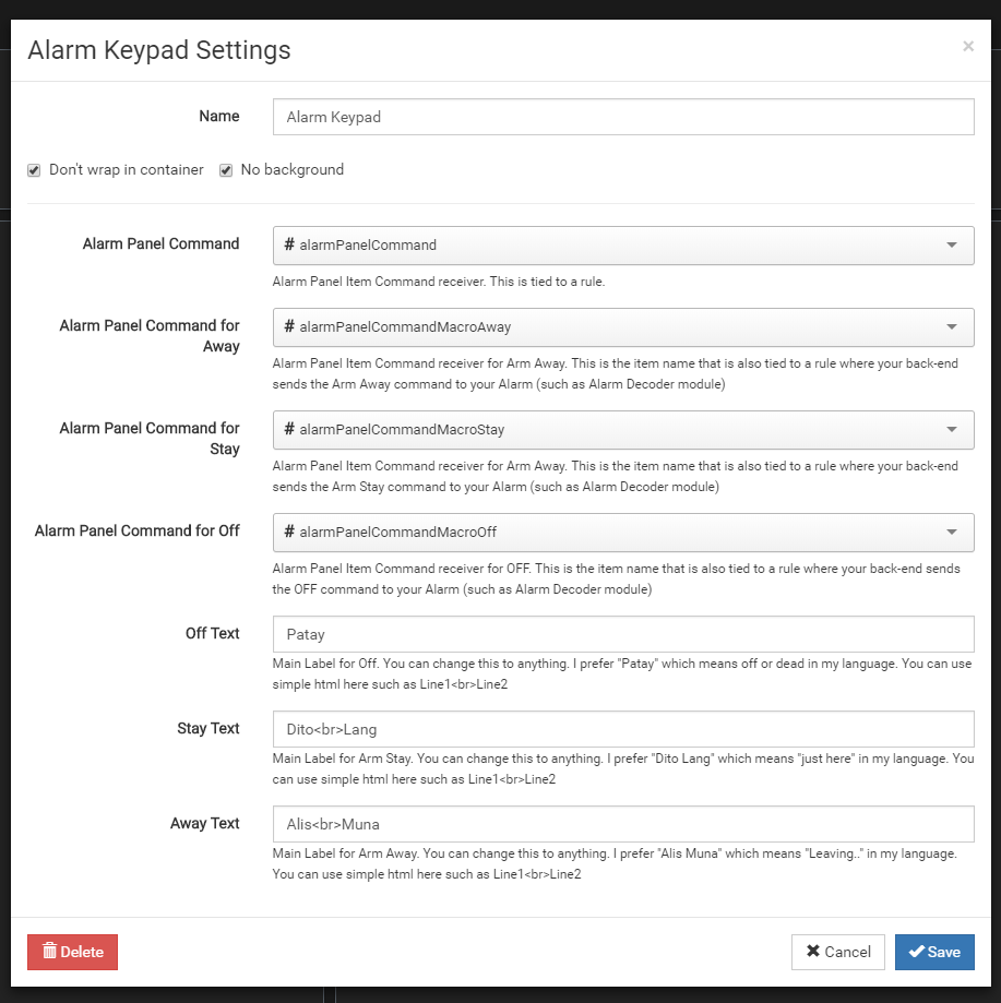

Config:
Config is self-explanatory.
When you hit a keypad button, it will send command to the item you configured for alarmPnlCmd. So when you hit 1, it will send 1 to that item. Few buttons on the left are special buttons, you can define which item receives those command. Commands for the left buttons will always send a value of 1.

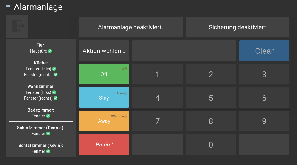

@DennisVonDerBey Would you share your complete Dashboard config of the pictured dashboard?

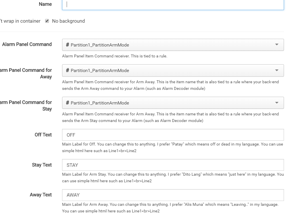

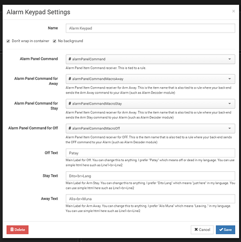

Thats weird. I enter in my 4 digit number and press off and I get for my status, partition Armed (ZEA)
This is what I have for my settings
ok fair enough. I’ll update it in a few mins
Updated. You can now define which Item to receive the OFF button.
So you can create a rule:
