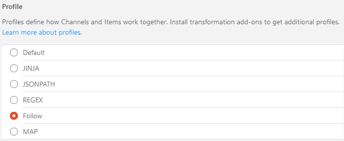

It’s not strange because state updates do not get forwarded to the binding. The Zwave binding updates the OH Item with a new state because you flipped the switch. But because it’s an update, the MQTT binding never sees it. MQTT will only see commands. That’s why you need a rule to trigger on the update and publish the new state to MQTT.
You could probably use the follow profile for this, but I’m not certain that will prevent infinite loops.
I see opposite behavior. A physical change at the switch to an OH zwave item (linked to an MQTT switch channel) publishes to command topic without a rule. Maybe my wires are crossed in the conversation…
I do use this in profile on item linked to MQTT channel, so maybe that impacts results:
Right, as I mentioned, the follow profile is what is converting the update to a command in this case. But that profile just does that one thing with little to no configuration options. I fear its too difficult to avoid infinite loops using it. Also, you need to configure every Item individually where the MQTT Event Bus requires less individual config.
As Rich mentioned, there could be risks associated with loops, but try using follow profile. Should make a physical change to switch publish to MQTT.

Using the follow profile has worked! Thanks both for your input, it was driving me nuts!
