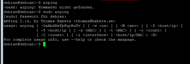

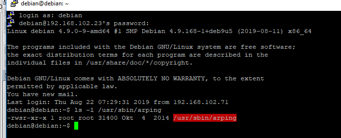

No, your sudoers file gives the openhab user permission to run the command using sudo. The command in the docs (chmod u+s /usr/sbin/arping) will elevate that one command to run as root without the need to run sudo.
Show the result of running ls -l /usr/sbin/arping.
Show the error when you run arping as user debian.
Here you are:
Without sudo it is in english: command not found
it’s really really hard to read screen grabs on my phone. Please paste the text into the post.
If it says command not found, use the full path to the command when you run it. /usr/sbin/arping

Without sudo and only the word “arping” it says command not found.
With sudo and only the word “arping” it tells me how to use arping (help text) with shortcuts and so on… So with sudo it is working.
Without sudo but with the whole path it shows the help text also, so this is working too.

Forget about sudo. Sudo is irrelevant for this. This is the only line that matters. The command isn’t in your path (which doesn’t matter) but you can successfully run it when you provide the full path. So now openHAB can run it too since you should have the full path to the command configured in the Network binding config.
