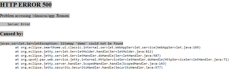

I have te sam e problems: 2.1.0.005, 2.1.0.008, 2.2.0.002 and 2.2.0.003 don“t read the conf - folder. BasicUI answers:
no need to say, that in the conf - folder the file demo.sitemap exists!

does openhab BasicUI read your conf - Folder? I tried it at the /volume1/public/openHAB2/conf and at the original folder, but basicUI says: sitemap not found! My Synology is a DS2013+ with DSM 6.1.3-15152 update1. The 2.0 Version worked fine.

The problem was not solved. The installation did not install for example even demo.sitemap. So I think, there must be something wrong but I have no idea, what …

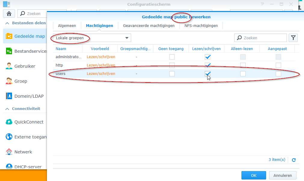

@walter32 Did you grant read/write access to the Synology local group ā€œusersā€ on the public-folder? This is a requirement.

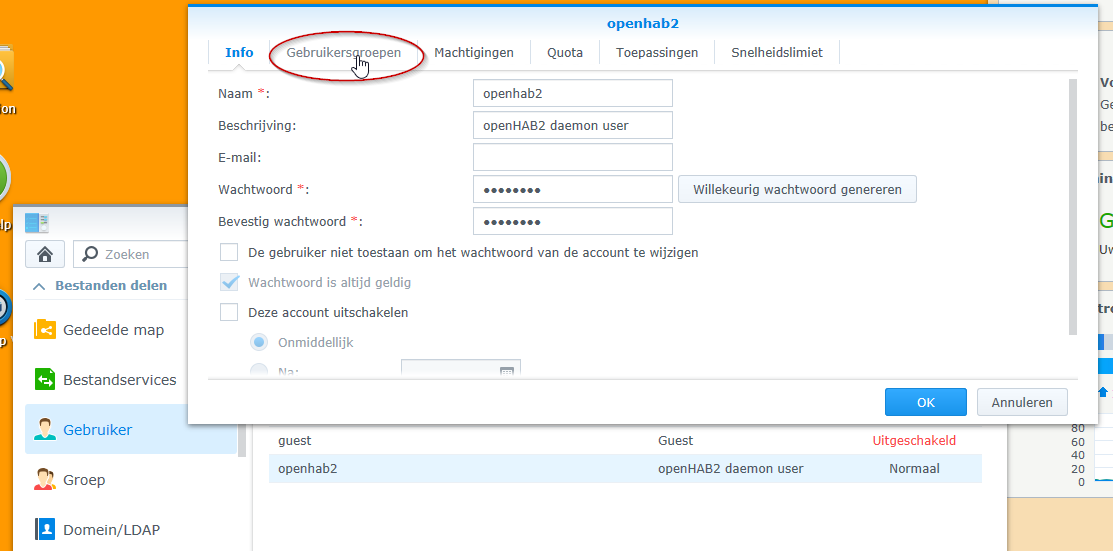

Summary
The installation process automatically adds a user ā€œopenhab2ā€ (as a member of ā€œusersā€ to your system, hence the above requirement) which makes it possible for openHAB2 to make a symbolic link to these folders and access them. You can check whether the installation has succesfully added the ā€œopenhab2ā€ user:
of course I did, I tried it with the admin-group too; I also made a local folder conf, but I had no luck …

There is absolutely no install documentation about the public folder. loovanloon provided the key for me that the public folder needed read/write permission for group users. No such requirement previously existed when all files were in /volume1/@appstore, the install took care of all permissions.
