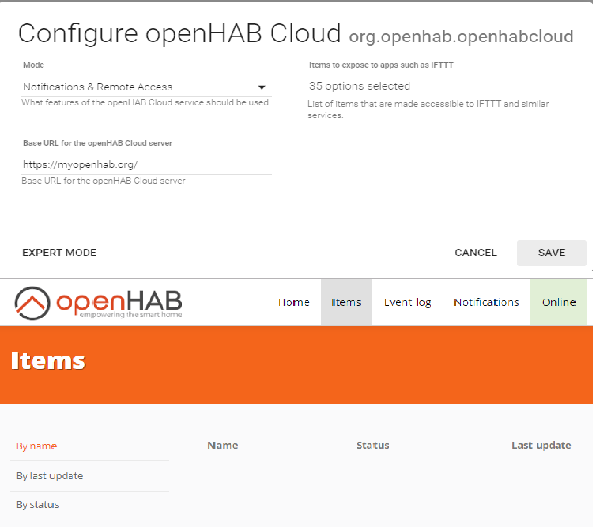

I installed OpenHabian Vers 2.4.1.0, everything works in local, the problem is that I do not see the items appear in the (openHAB Cloud - Log in).
If I use (https://home.myopenhab.org/start/index) everything works.
I installed openHAB Cloud the configuration is done see below:![1|690x348]

You need to change the state of the item at least once to see it.
This is disabled currently as it puts to much load on the server:
207/5000
I have also changed the status from OFF to ON and vice versa but nothing.
So from what I read is a DB problem where it is hosted, you need to be patient until the problem is solved
We hope as soon as possible.
If you don‘t want to wait, setup your own cloud instance and connect IFTTT to that instance.
Searching the forum will give you helpfull instruction how to setup.
