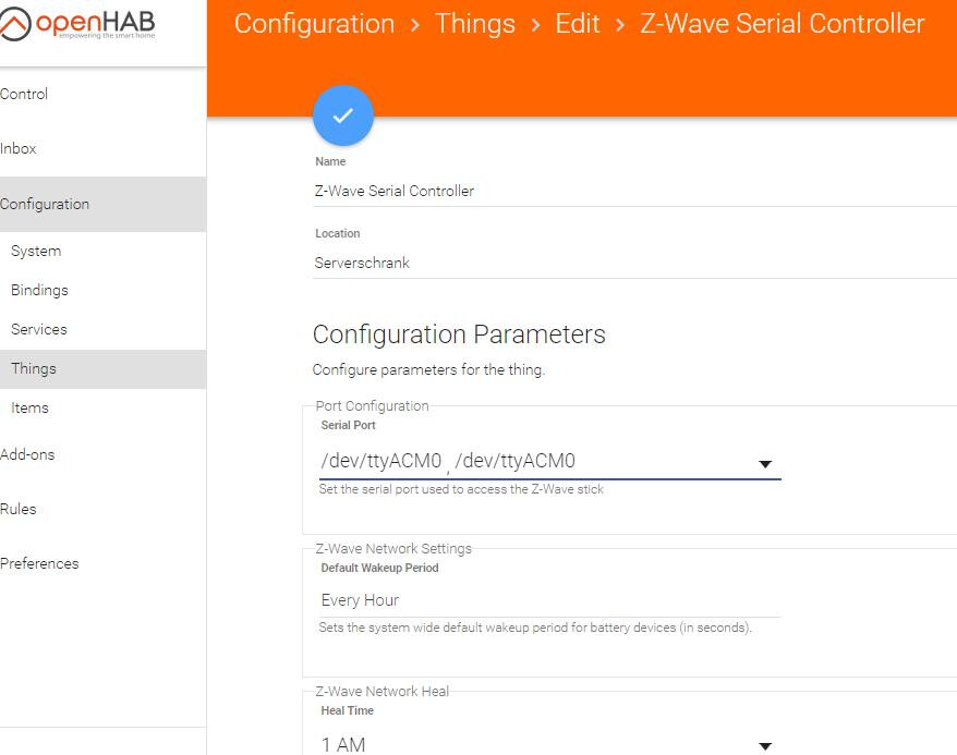

my z-wave stick dont be seen in openhab, see screenshot.
i have tried readding the stick, same issue.

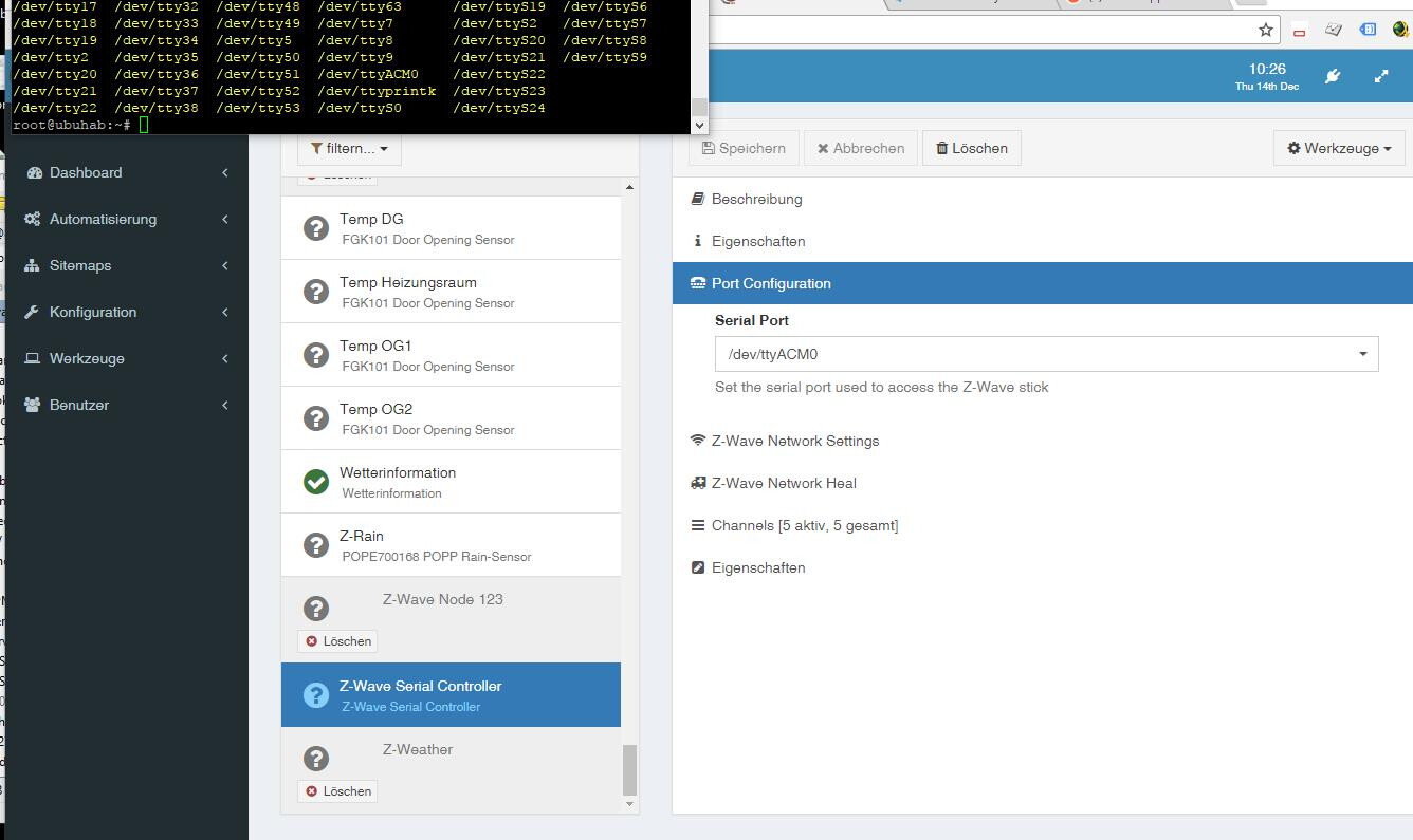

i just find these error logs
i just find these in paperui
seems to be double entry ?
and cant be changed (dropdown)
