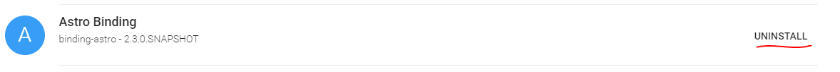

I’ve just started a new post. After watching a youtube video it seems that after adding bindings and things I should see something in the Control section of Paper UI - but it’s empty. Also I would like to remove the plex binding which I don’t really want or need. Can’t see any way to do this from the GUI.

Go to Add-ons and select the “Bindings” tab. Scroll down to or search for the binding and click “Uninstall”.
